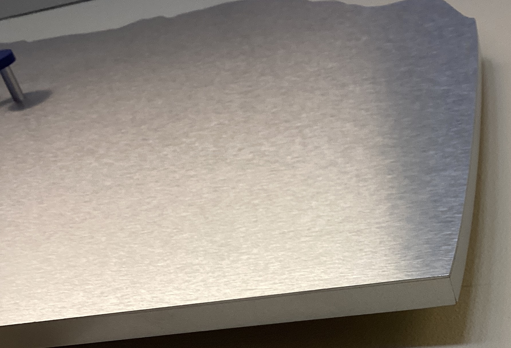

Yo, Looking to make a sign like this. Brushed aluminum face 1/2" deep with brushed aluminum edge banding (1/2"). Probably just Plywood base with contact cement. I have a sheet of brushed aluminum ACM but this doesn't look like ACM. Any ideas? I could bevel the edges of the ACM and glue....

Looks like actual brushed aluminum sheet welded or glued together. Should be able to source from most metal distributors, but it gets expensive for a one off. SteelArt would fab it up for you though.

Wrisco makes .030" to .090" (I think) brushed sheets. My guess is this is .030" or .063" (hard to tell the scale) glued/laminated to a piece of PVC. Most of your aluminum/metal suppliers will have the aluminum, as will quite a few sign supply outlets.
