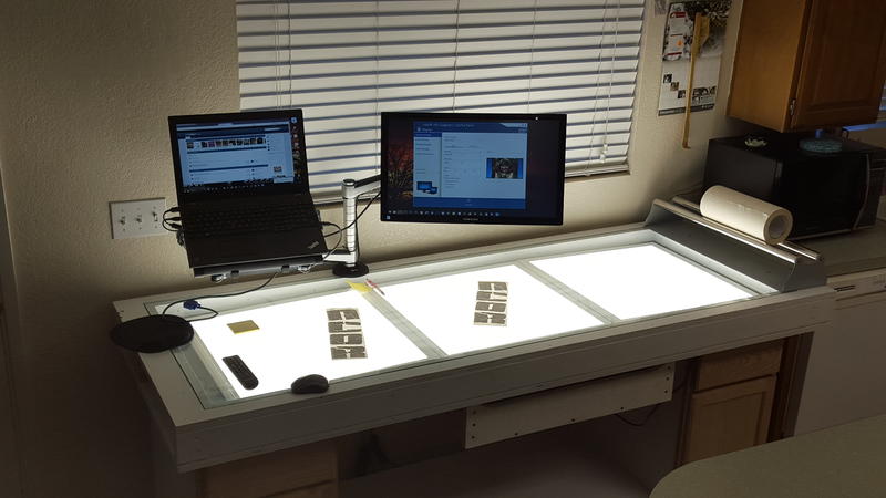

this is the table i made from scratch , no plans were used at all, built as i thought of it and its for the size of jobs i do... It works perfect with no glitches.....and here is my table on youtube.. 3 remote control lights, swing away monitor and laptop stand. i can do multiple layers/. I use led panels which you can get from home depot , but i got mine from a local rep that sells a better brand.. each light is 5500k anfd the glasss is 1/8 inch thick. the glass shop said its strong enough to let me stand on it with no worries.....I said im not going to try it .but he promised its very strong.. My glass area is 28" x 76" long. my next table will twice the size when my design room is finished.. I hope you like it .. Dwayne
