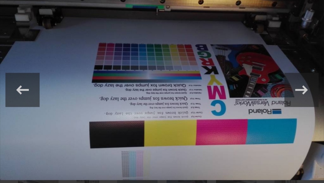

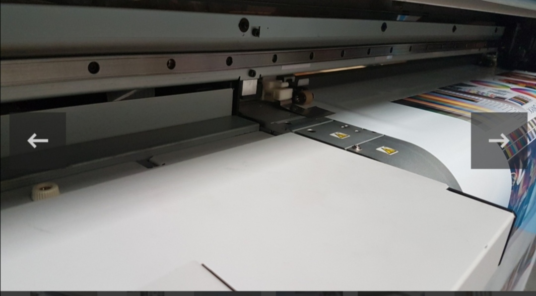

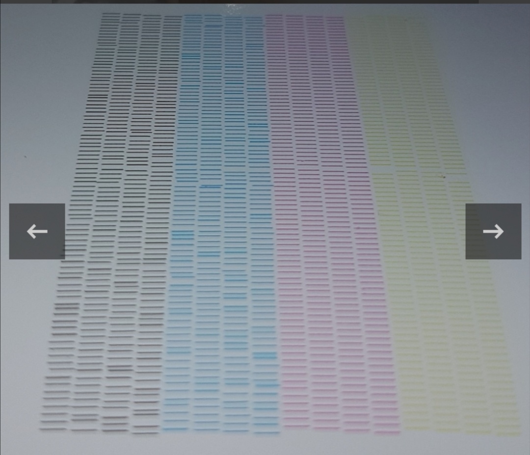

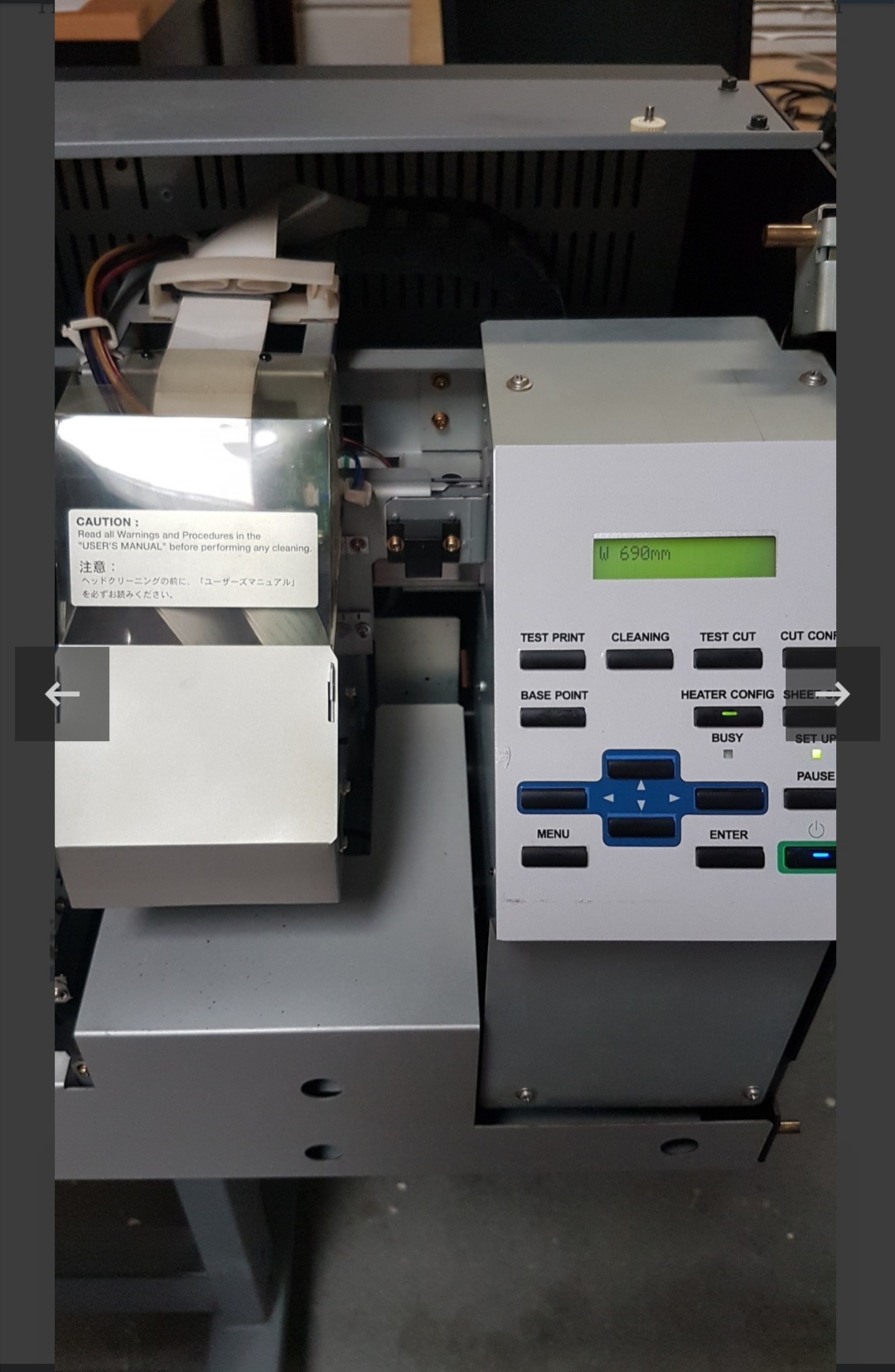

Now I ran into a used Roland SP300 for €2300.
Acording to the seller it is in great shape.
However I know nothing yet about these printers.
What are the things to look out for when buying a used Roland printer?
How can I check it is in good shape?
What costs can I expect on this printer model?

I have an SP-300V (slightly newer model) that I have been printing with for well over 10 years. And I bought it used. These things are workhorses but the only issue now is parts are getting harder to find since they are so old. Main parts like consumables and even heads are still available but if a rare part breaks it may be hard to get a replacement. Make sure the test print (in the menu) looks good before buying. Otherwise you could be stuck spending another few grand out of the gate.

Well yellow and magenta is decent, black and cyan not so much. You can see banding and if your core stuff is making small stickers it probably won't look as pretty as it could. It just has a lot of deflected nozzles.
There was no picture of caps but if I bought it, first thing I would do is change caps and wipers to new ones and clean the heads good as well.
Worst case you buy it and don't like the output on small stickers. Go look at it and test print your own file. See how it looks.
It's not SP-300i which is the newer one, so it's SP-300(v). It's old model and if it breaks you can have a hard time to find spare parts. So keep that in mind.

As for the original post, that test print looks like there are a few deflecting nozzles. It's not a deal breaker but I would offer less than asking price since deflecting nozzles are a sign the heads are going to fail sooner rather than later.
