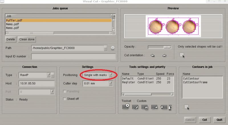

Nobody using Caldera for print/cut? Just need some pointers on how to setup caldera. The reg marks are facing wrong direction and caldera will not read the reg marks or I would just change it on plotter.

yes type 1 VS type 2. Caldera will not even try to read reg mark. It goes straight into cutting instead of trying to read reg marks. Hows come caldera has different setting in the menu for the different reg marks if the software only reads type 1?

What do you have for the "Positioning" setting?
See image...

same as you have there, in the "status" it said could not find marks and plotter did not even try to find them.
