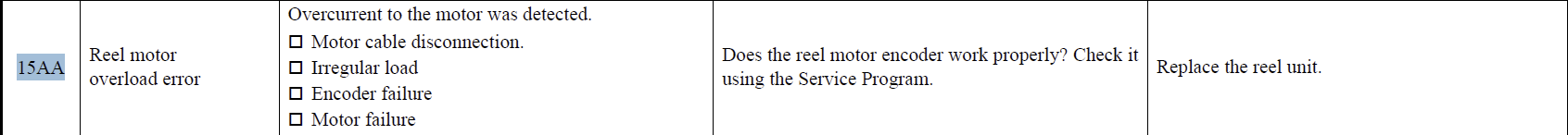

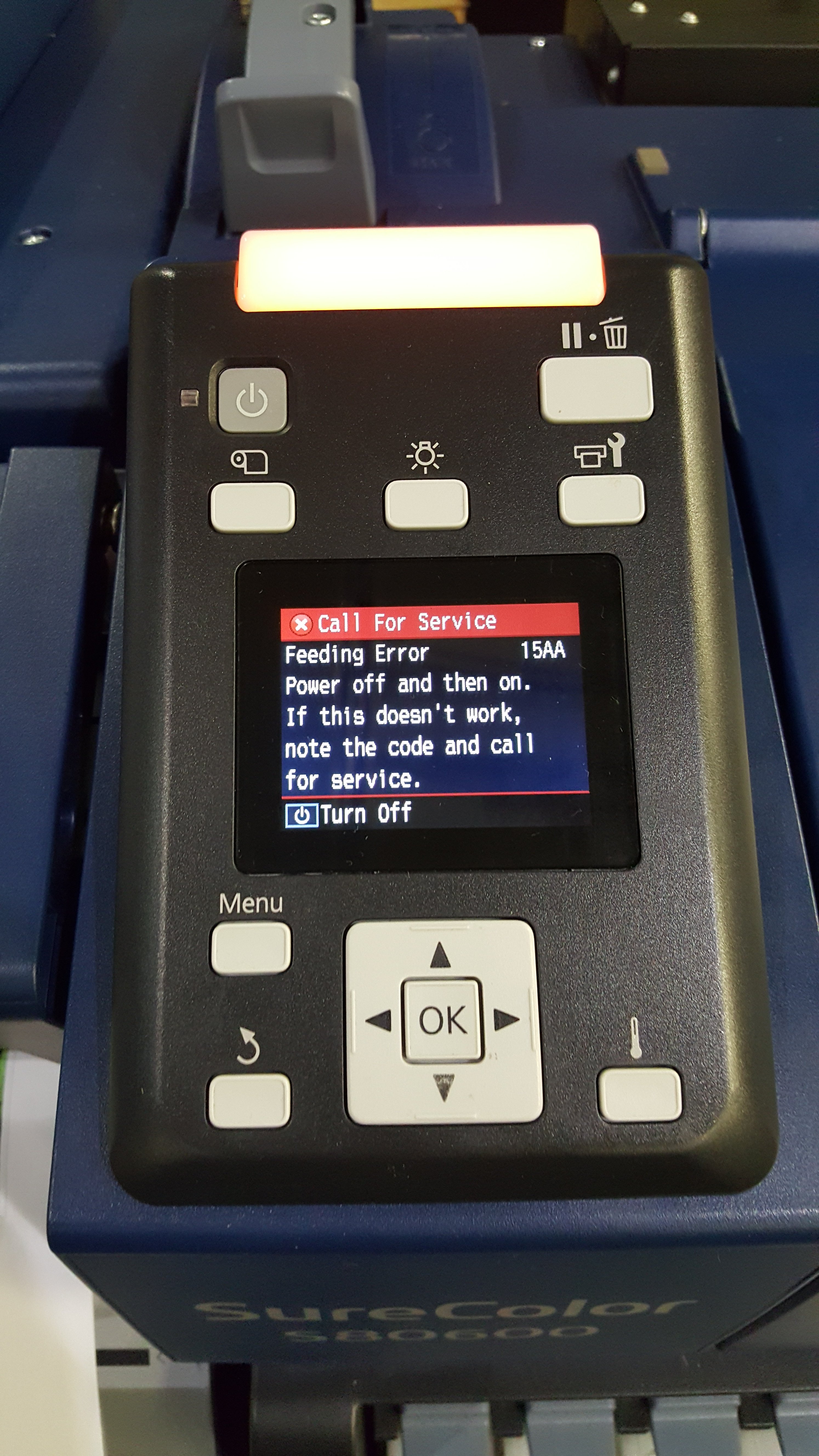

I keep getring an error everytime I pull down the lever to activate the take up reel. Epson 80600.
