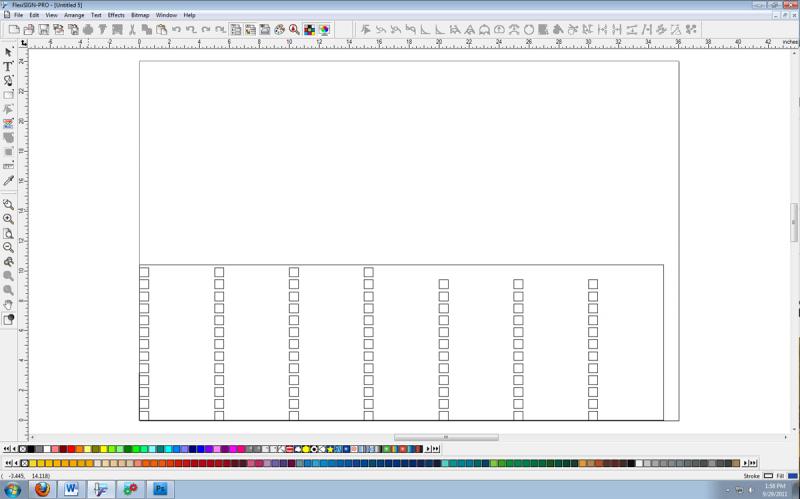

When I try to create a color swatch of my current table or CMYK, it just opens the outlines of boxes where the colors should be without any colors or names. It is non editable and give me no option to print. Any ideas? Running Flexi 8.6 v2 build 1472
dj_elite
Here is a picture of what happens. Once I click the arrow or a tool it disappears

dj_elite
Anyone have a clue? I need to print these. I just got a new printer and have to have swatches for color matching
RG
Definitely a glitch in the matrix. Or a disturbance in the force. Try copying the cmyk.swt file from your install DVD and pasting it over the same file in the Flexi Swatch/Table folder on your computer.
dj_elite
I feel like an idiot! I have two monitors. My design central is on my second monitor. When you create a swatch you must confirm and click the check box in design central. Which I was not expecting. Ooops!
