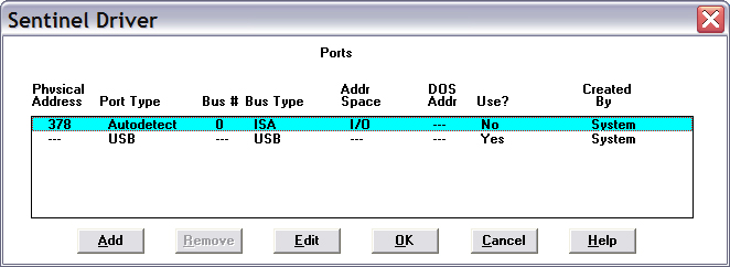

I would check your port configuration through Control Panel for correct settings and that your USB port is set to never go to sleep in the power saving settings. The config referred to earlier is the Sentinel Config that looks for your dongle. It is accessed from Start > Programs > Gerber Omega > Sentinel Config. If you can't find it, here's a direct path to it: "C:\Program Files\Common Files\SafeNet Sentinel\Sentinel System Driver\SetupSysDriver.exe".
The idea with it is to have it only look for where the dongle is and to have it not look where your Edge is plugged in.

Your screen may look a bit different than mine which is from Omega 5, but the idea is the same.

My screen looks about like yours.
It has 2 entries, first line says port type = ECP and it says no
2nd entry says port type = USB and says yes to use
