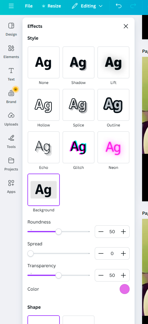

I read somewhere once that Canva doesn't have the "outline text" option - but in canva world it's called "Hollow", or something like that.

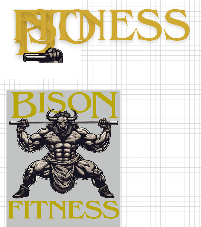

I have a question for you about canva: I have customers who send me artwork in canva all the time. I tell them that if they are going to use canva, to make the pallet the size that they want the actual graphic to be. The must send it over to me an a png or jpg. EVERY TIME they send me a pdf exported from canva and I drop it into Coreldraw, the file is "corrupted". I THINK its because canva has some sort of protection on their pdf files...but I don't know enough about it. I thought maybe your graphic arts background could clue me in?

Yeah, Corel don't like them there convoluted Canva PDF's. I usually try illustrator then save again as pdf. I did try this sight that was mentioned earlier. It fixed me up too.

Usually it's for banners so I tell them to make it in the pallet size they want (3x6, etc). HOWEVER, it looks like the free version of canva only allows them to go up to 72". But when customers send me artwork, I generally tell them I need a pdf.
BUT, every time someone sends me a pdf from canva, coreldraw says that it's a corrupt file and doesnt even let me open it.
Two days ago I had a customer come in who had created her logo in canva. She sized it at like 5 inches. She wanted me to print it 24"x24". I ended up resampling it in corel to bump up the pixels. It turned out pretty clean.
But i'm just curious why the pdf comes across as corrupt when I bring it into coreldraw.
