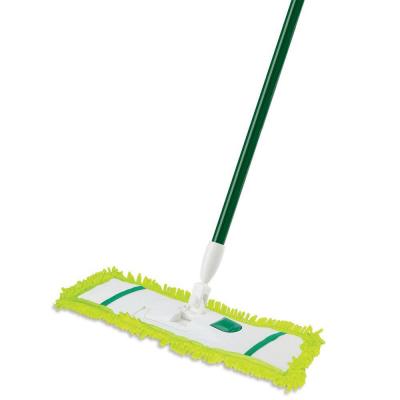

I can't tell you about the CET static reduction, but
I do have a simple DIY system that has worked great.
Get your self a microfiber dust mop and place
on the backside/inside of the mop head a piece of thin aluminum, a little smaller than the microfiber head,
Then run a copper wire from the aluminum, up the handle to the ground of a plug (ground only, not hot)
and plug that in to an outlet.
Don't wet the mop, run it dry over the substrate, works like a charm, I should patent it :smile:
If you still have issues, wet wipe down the PVC before you remove the protective liner.....

Thanks, I'll have to try that. Do you go over both sides of the substrate, or just the side you're printing on?
Andy D
I wipe it down on the printer, right before I start the print, so just the side I'm about to print.
