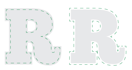

Question about bleeds, as I know a bit about it but not everything.. My understanding is it works well when printing a full sheet and you want some extra print to the edge of the paper or just past your crop marks. Does applying a bleed, using illustrator, work the same when printing out lettering only to be cut out? Will it print a bit extra on each letter to compensate for the cut being off?
You need to set up your files like one of these :
Using the offset path in Illustrator.
If you go with the first version (no white border) make sure you wait at least 30 minutes before cutting as the vinyl will curl up if you cut it before outgassing.

Okay perfect thanks. I had a feeling that's what I had to do, using offset paths, but you google it and all that comes up is adding bleeds in the printing menu of illustrator, for normal printers I imagine

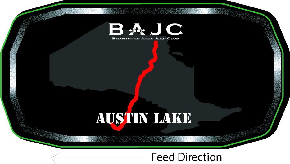

Hey guys, Idk if anyone can help with this. Grown tired of my cuts being slightly off but all of a sudden it went from manageable to worse. I've attached a pic from illustrator showing my cut contour line being brought way to the left to get the printer to cut out properly (centred) and wondering if anyone has any suggestions to look at in the machine setup. I've got a bleed but it cut so far to the right that it was hitting the white, it cut the opposite of the cut contour in the pic I uploaded. Orientation is a 90 degree rotation so they're printed sideways, the cutter is actually cutting too far back, it's a front to back issue not side to side. I've wasted a bunch getting the cut fixed and figuring where I need to set it up in illustrator and then importing that file to cut but I obviously can't go on like that for every file.
What kills me is I spend half a day Monday adjusting the pointer offset, the 500 mm square adjustments and a couple other things to get the cut dialed in, which is was for that particular job by the time I was done. Then I print Tuesday, laminate today and begin cutting to have it cut way off.
Losing my patience with this thing as we just spent a few week dealing with print/head issues which are finally fixed properly and working great, to now the cut being off.
I'm hoping someone can give me some advice as to what to check or re-look at as this is brutal and I may need to call in a service tech from one of my suppliers to look at it, which I'd rather not do plus I need some jobs done before the holiday shut downs.
Thanks in advance!

Are you using crop marks? If so, have you adjusted the A and B offset in the mark detect settings? If the cut is off by the same amount every time, that's the setting you need to adjust.
AdamDG
Yes we are, but no I haven't adjust that one. Is that in the maintenance menu as well? Does the operating or service manual tell you how to make that adjustment?
Solventinkjet
DIY Printer Fixing Guide
It's in the mark detect settings. You have to be in cut mode and then just hit Function>Setup>Choose your tool preset>Mark Detect
Once you get to Mark Detect, just hit a few times and it will scroll through the Mark Detect settings. 2 of the settings will be X and Y offset and those basically move the cut to where you want it. I said A and B offset before but I was thinking of a standalone Mimaki cutter. In your machine it's called X and Y offset. I usually print and cut a crosshair and then adjust accordingly. Just keep in mind that it's backwards from what you learned in school. X is the up and down direction and Y is the left and right.

Okay I was wondering if you meant X and Y, I will check that after I finish cutting out the last few rows of the decal I already adjusted for, before starting the next cut. Do I need to print something before starting to make that adjustment, to make that adjustment with?
Solventinkjet
That's where I usually print and cut a crosshair. It gives you an idea of how far you need to move it. It will take a few rounds of printing and cutting the crosshair and changing the adjustment to get it spot on.
AdamDG
Okay thank you, I will give that a try and hopefully fixes my issue. Thanks for the quick replies as well and have a happy holiday season if we do not chat again!
