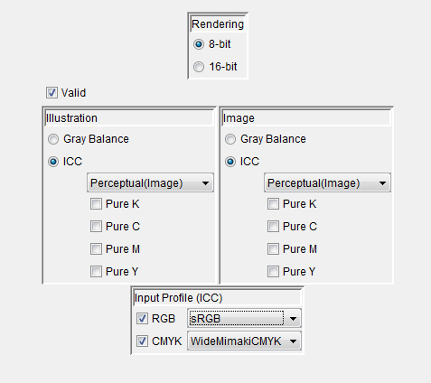

These are the settings it has now. Which prints fine on glossy sticker paper, but not the photo paper. We use the same settings for banners as well. I didn't see any other settings to change it to.

The images you attached are displaying the Rendering Intents and Input Profiles, but not the Output (media) Profile ink limits.
Glossy media many times can not accommodate or need as much ink as other, more absorptive medias. Each media is unique in terms of it's interaction with your ink. Over inking the media will cause drying issues, ink transfer and smearing on take-up etc.
You can try to crank up the heaters in an effort to fry the ink faster, but if you are significantly over-inking, that alone will probably not be sufficient. The best solution would be to obtain or build a media profile for the media that you are using, that is built for and accounts for the media in question.

I tried a couple of different profiles/setting and even tried regular paper (no gloss) it's still doing it. But works fine on banners and glossy sticker material.
