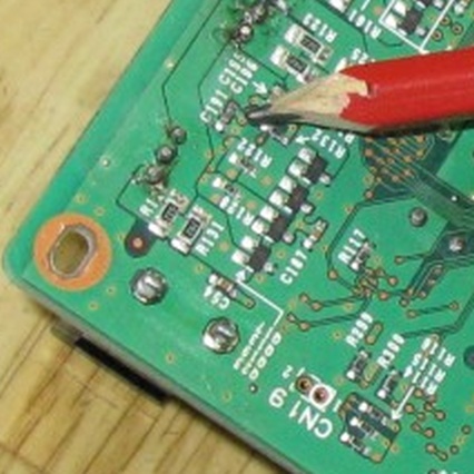

We had similar problem ages ago - was TP5 too that tested low. Turns out it was 2 blown transistors on the mainboard.
They are C4550 and A1742. My brother did the diagnosing and fixing, but it did fix it.
Here's a pic of him pointing to the area on the mainboard
