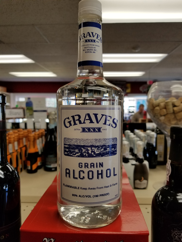

Well, here is my answer to my own question. It's available at any local liquor store for a reasonable price. 95% Ethanol.jpg
