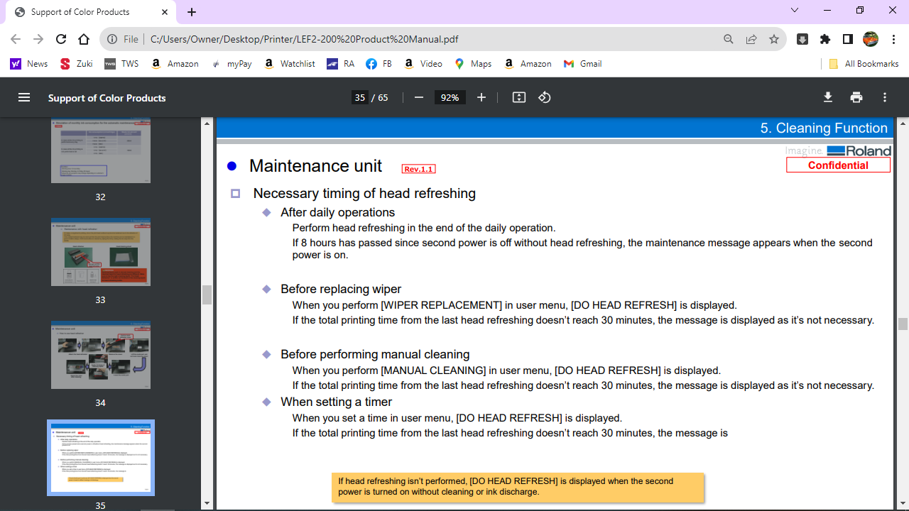

I'm perplexed. Between what our Roland Tech said at installation and what I see in Manuals, there is an inconsistency.
With regard to doing BOTH a Manual Cleaning and Head Refreshing (as conducted by the User's Manual), which evolution occurs first?
For instance, how would you interpret the sequence from this portion of a Roland publication?
