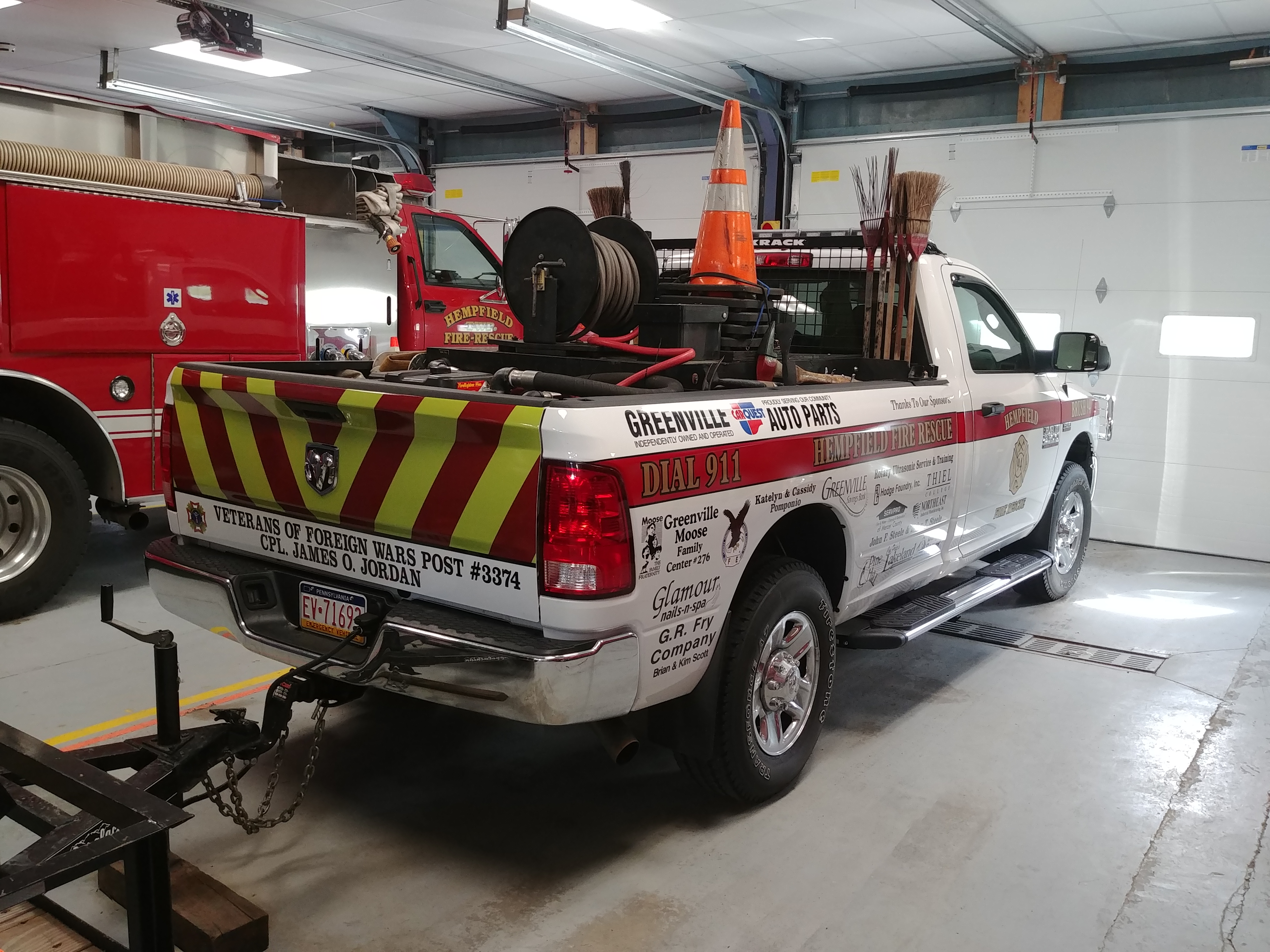

I've printed red & yellow-green chevrons for fire trucks before.
I use 20,100,100,20 or 10,100,100,10 for my red and 30,0,80,0 for yellow-green. I print it on one of our mimaki c/jv150 from signlab 10 on a photo-bidirectional (16 passes/inch roughly) profile.
One tip I do too is after I laminated the chevron, I put it on top of 3m ij180c-v3 before install to help with installation & removal later since reflective is such a bear to work with.
