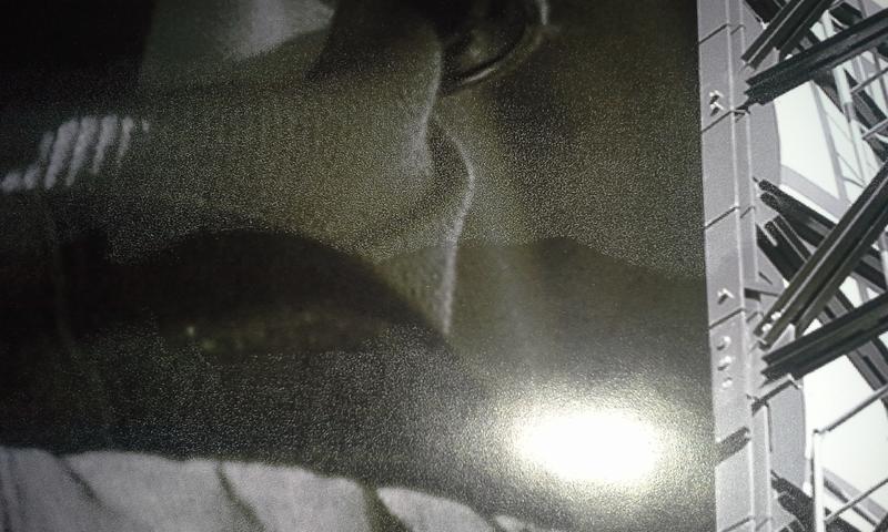

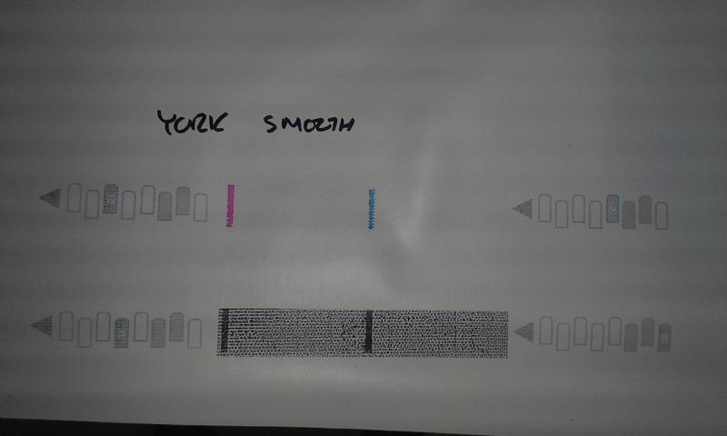

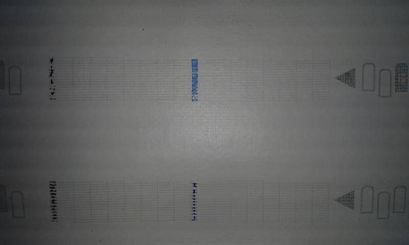

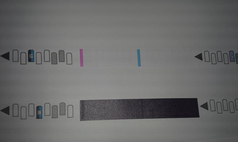

Okay, so you can see in those first two examples (and forgive me, these are all camera phone pics) the type of issue I am trying to describe. There are more severe examples than that, but honestly I tossed them all in the trash.
You can see in the printhead status plots that on another media (DreamScape Mystical) that the status plot printed fine. However, it's just a mess on the York Bright White and the Matte Vinyl. It may be related to ambient conditions. The humidity here in OK has been very high.
Oh, and I forgot to mention, I was originally using the DreamScape Suede profile (which has worked with all the DreamScape media), but I have altered all the settings at one point or another (and I only modified one setting at a time to at least attempt some control). I started with 12 passes, 100% ink density, then went up all the way to 20 passes. I tried dropping the ink density, increasing the ink density. I raised the optimizer level (because the optimizer test plot showed that increasing the level *may* have helped, but I think the stuff is just so far off that the tests aren't reliable). I increased the inter-pass delay. I ran a substrate advance test, it was dead on.

Yikes, those last two images look like a chemistry problem to me. The only time I've seen anything like that is from folks running 3rd-party inks (non OEM latex ink). From the images you are showing, it appears to be a chemistry (ink-media) issue with these medias. As I mentioned, I have run Several Dreamscape media products, including Plaster without seeing anything of this sort.
You're not running a 3rd-party inkset are you?
