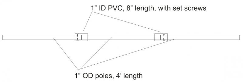

excuse the crude drawing, but this is my first notion...

not an ideal solution but i have seen expandable/telescoping painting poles used, they collapse to about 34" and you can screw them into each other to connect them. some expand 3 times their collapsed width.
I don't think a PVC pipe is going to remain straight... or even near straight for 12'. If you put sleeves in there, it's probably going to make it bow even further. I've often told cheap customers to get a telescoping paint pole too, but it the end, it doesn't really work because the pocket needs to be hefty to fit the bottom end of one of those.
For the most part, when making a banner for parades and such, we put a pole pocket on the bottom and on the top. The top if it's over 8' wide, we suggest an aluminum pole so it's lightweight. In the bottom we suggest and will supply chain for two reasons. One, so the banner stays flat and no curl at the corners and the other is so the banner doesn't whip around if it's windy. We also use the chain in the bottom in case someone hits it with their shin, it won't hurt them.
Having to ship this thing around the country would probalby make it a bit awkward, so I would use a combination of what jhill mentioned but I'd make it from aluminum with a long threaded sleeve and an inner thread to hold a solid piece of threaded rod to keep the middle from bowing.

Thanks for the great advice. I'm going to look into the threaded aluminum idea.
