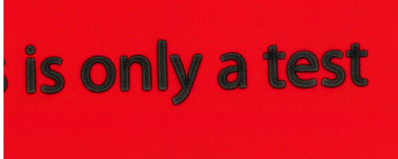

In the last week I changed the black/yellow and magenta printheads. This is only the second time in a year of owning the machine. We noticed a huge change in color, seems darker then before. Reds and blacks are bleeding together. See attached. Talked to HP and we got a new set of printheads to try. No change.We use Onyx Postershop 10.1.5.

What design program are you using ? I have had same issue while using flexi I changed to cmyk or spot colors and removed strokes and it went away.. Was in RGB mode Issue was when two deep colors touched like maroon and black... Good luck

Negative Ghost Rider, the pattern is full.

I have recently had the same experience with a L26500. The final conclusion that I came up with was to switch back to running HP profiles and not the 3M or Avery profiles that have been provided by the manufacture. HP could not figure out the reasoning behind this other than to say that the saturation level in the non-HP profiles was slightly higher than the levels in the HP profiles. I had changed heat settings, passes, vaccum and uni & bidi. Nothing seemed to help. At one point 3M & HP asked me if the vinyl had discoloured from the high tempurature I was running (245° F). Good luck and I hope this helps
Is everyone who has seen this issue seeing it specifically with black/ darker red color combinations?
One more thing you can do on the L26500 (with current firmware v8 or higher) is to use the Inter Swath Delay (Ink Menu > Image Quality Maintenance > Inter Swath Delay) and set it to .5 seconds. This allows one print swath more time to set the dot before the next ink pass is applied.
