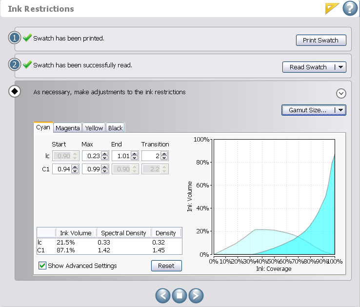

eye4clr
Your screen cap is a control for light ink to dark ink in cyan. This is a control applied before, during, or right after linearization.
