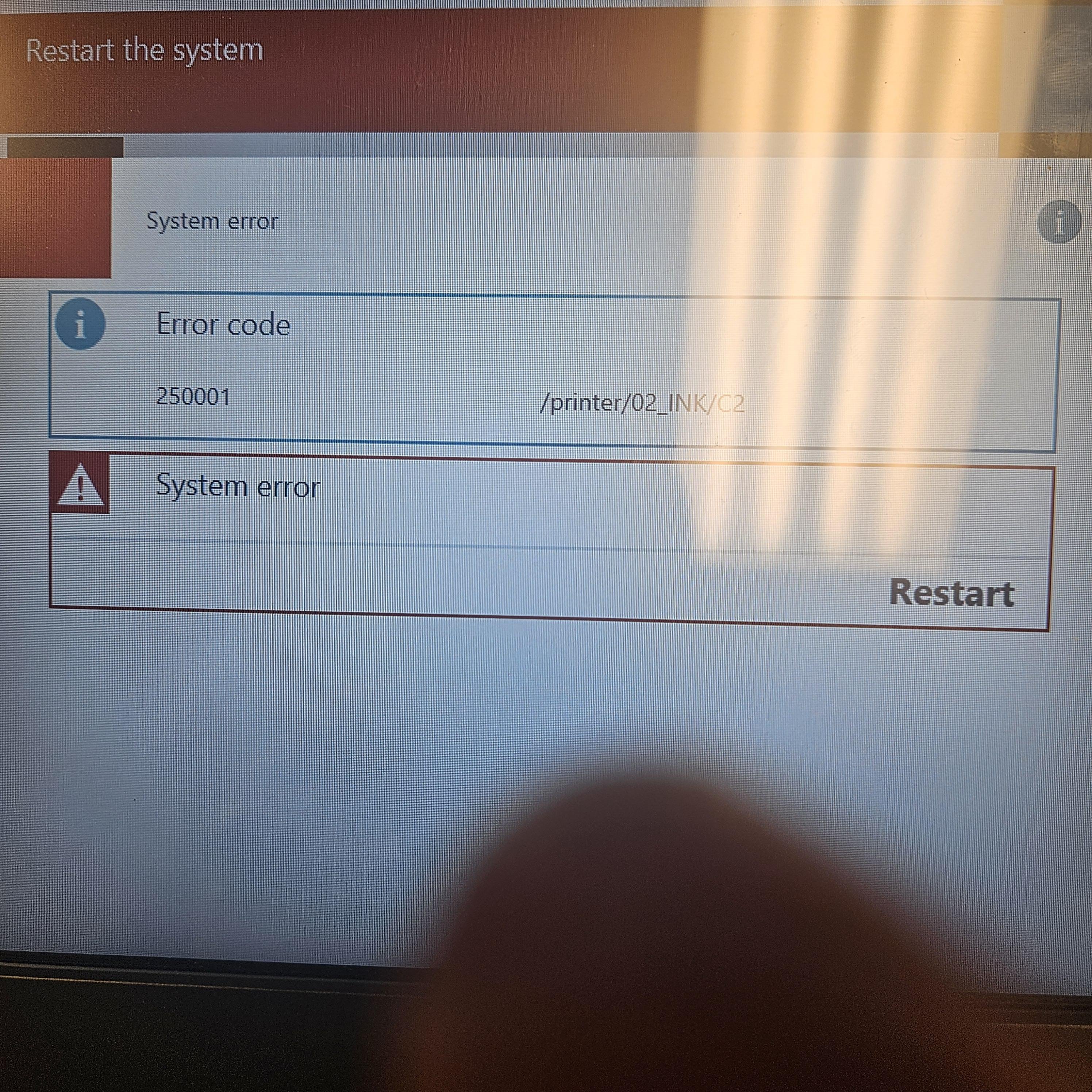

We are getting an error in the middle of our run 250001 /printer/02_INk/C2 . We just had a tech out who said everything looked good this morning, and now this is popping up. Do you have any ideas, please?

Probably the Ink Pump tube. We've never had to replace them on the 1650 but have on the M.
On the M it actually says Ink Pump but it's the same error code.

late response, but you should consider changing all of the tubes annually (assuming you run the machine most days). They start to crimp over time and starve the heads. My tech does this all the time and it avoids a lot of problems.
