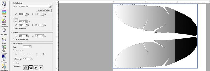

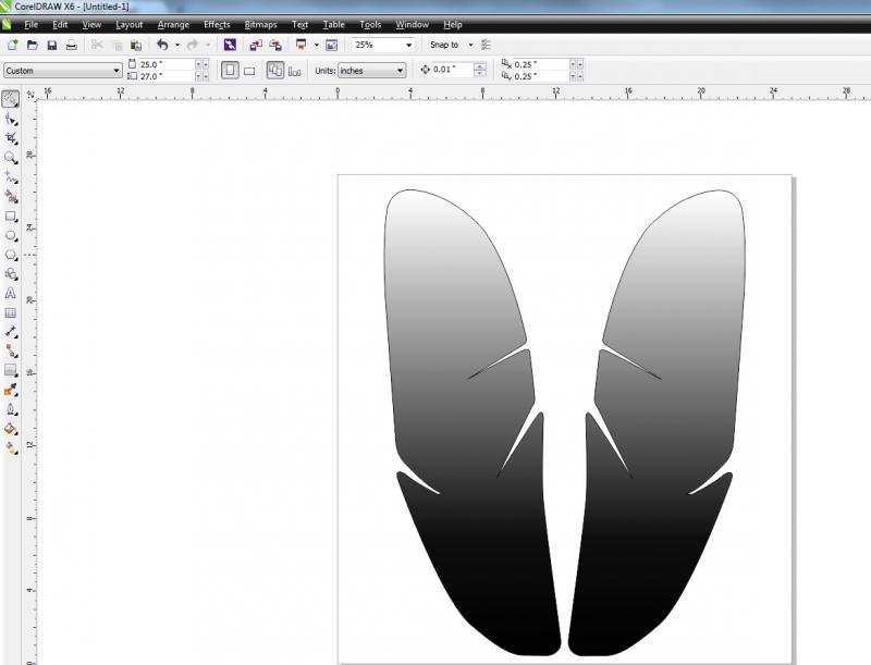

I've been working with this for for well over an hour now and I just can't get it . I have changed it from EPS to PDF and that didnt help... Whats wierd is I have many gradient files and never had this issue come up before.
I am posting 2 pictures.

did you get this file as .eps or was it made by yourself in corel and exported as .eps, reason i ask is sometimes full vector gradients can play havoc if created with some versions of illustrator or another vector drawing program, i would either do a refill gradient in corel again then export as .eps or pdf, or trying bringing it into adobe acrobat professional and go to tools, and then save again as .eps, you would be surprised what adobe acrobat can do, its especially good for pdf's created out of jpegs, and they can sometimes crash half way through printing and/or give bad printed output.

have u tried actually printing it, regardless of what versaworks looks like? The color representation in Versaworks is 99% incorrect, everytime.
eahicks
I've never trusted VW's preview...it always shows wrong. Blues will look purple, and once you print, it's blue.
I would print it and THEN troubleshoot, if there's an issue.
