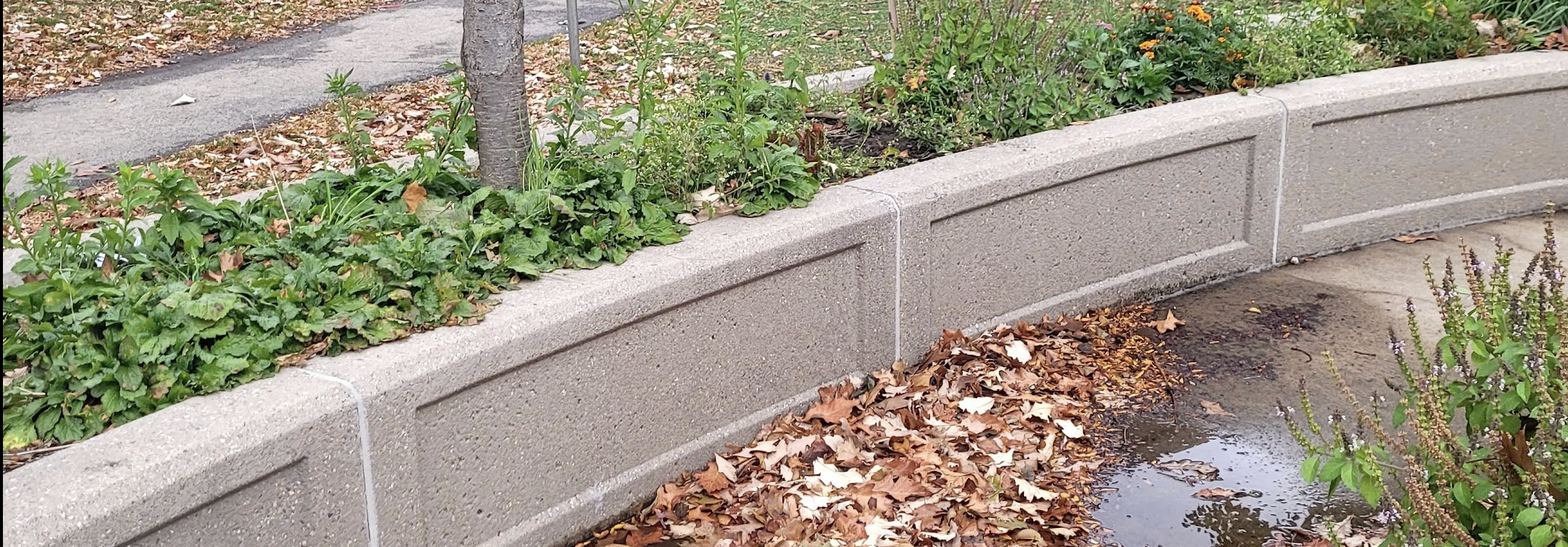

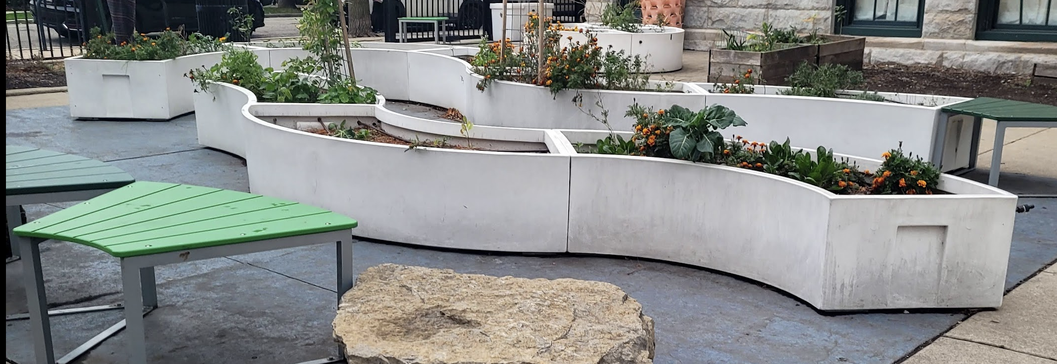

We are making signs on 8.5 x 11 coroplast to mark the gardens -
some of them are in garden beds in plastic and cement
I thought we can add decals to plastic - thoughts vinyl with lam - type of vinyl recommended?
Question : any one has a vendor that does utility /marking signs size 4" x5" that do full color and double sided?
What about your thoughts on the cement ones. See pics.
Thank you .

What are you marking the gardens for? A coroplast sign is a temporary sign. Are these meant to be permanent signs or temporary markings?
defarge
You would be better off using aluminum blanks. Print on quality vinyl, apply to the aluminum, and laminate with paint protection film for extra durability. I made some landscaping markers for a large garden that way, they look great after 5 years.
glow30
the the small marking flags are just temp for landscape not to mow and damage community garden
