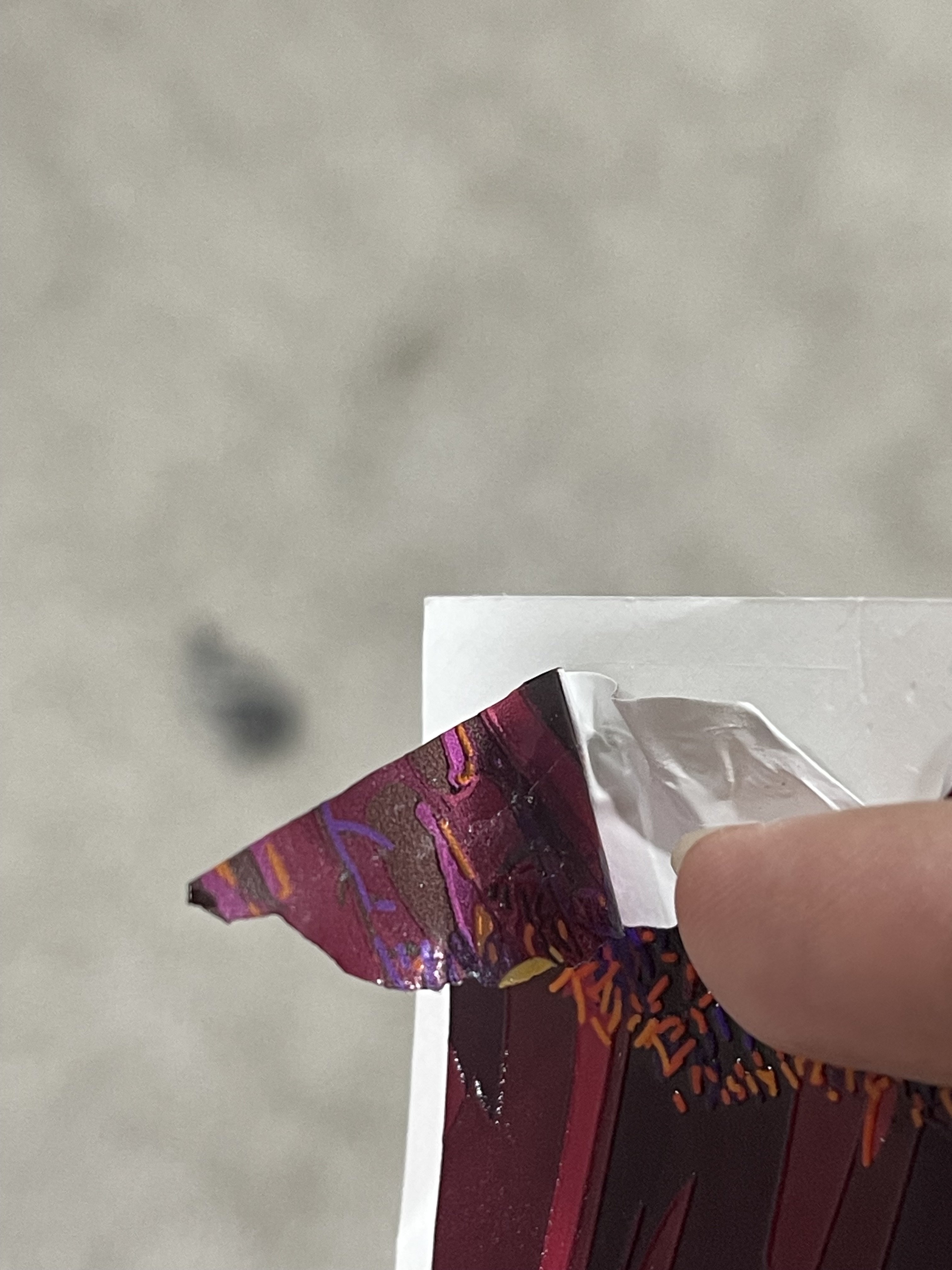

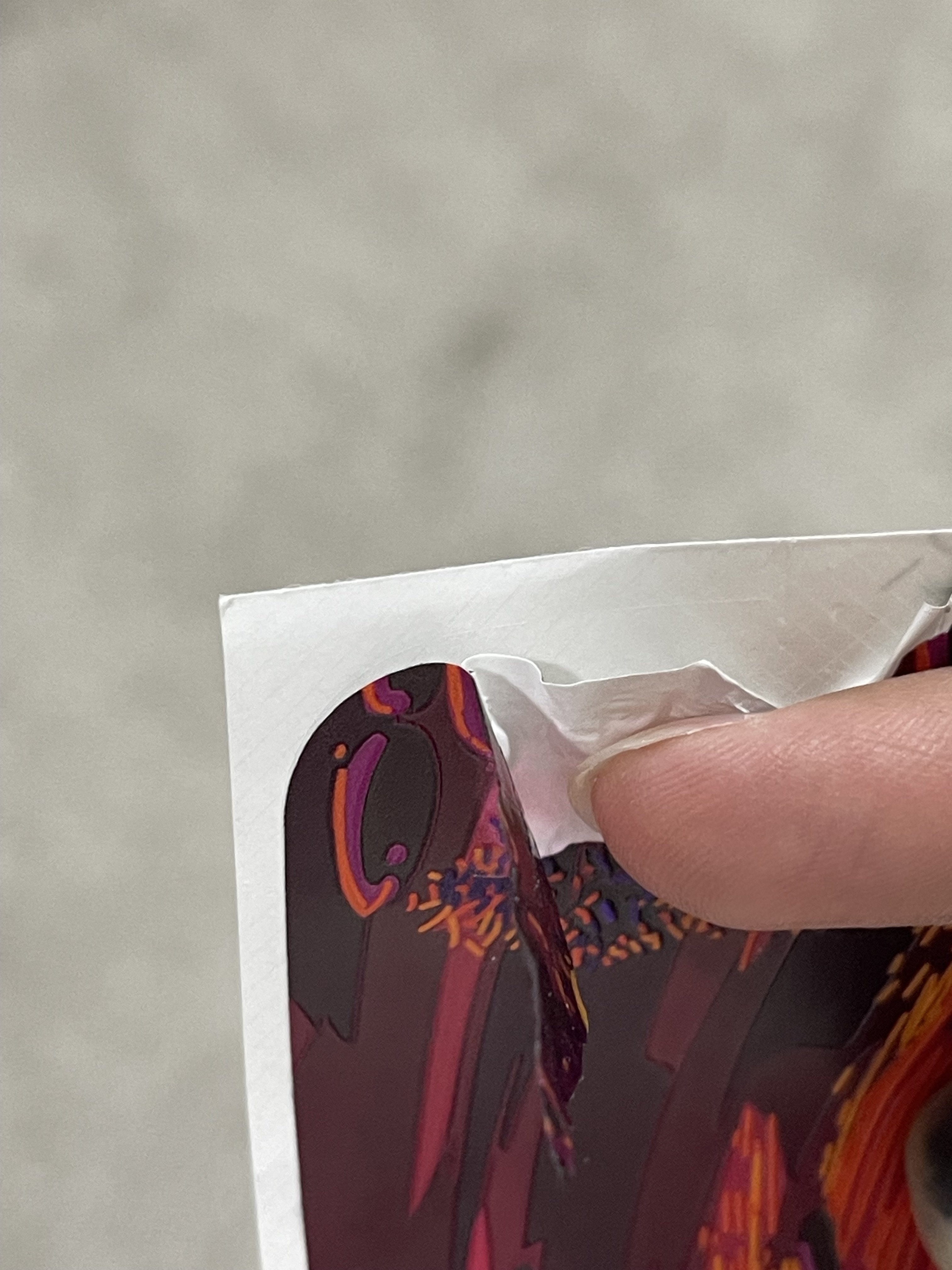

We have a phone and laptop wrap (decals) business. We previously used 40C film, but the adhesive wasn't effective enough. After posting about the material our competitor uses, I discovered they use IJ180C. Today, I received samples of IJ180C and noticed they are thinner than our competitor's materials. I couldn't wrap my head around it; then I started digging into one of the samples we bought from them.
Upon removing our competitor's phone wrap, I found a clear, adhesive layer on top of the IJ180C print film. This layer was not on top of the printed design; instead, the design was printed on top of the clear material. What is this transparent, adhesive material?
Is our competitor laminating IJ180C with this clear layer and then printing on top of it? Or are they applying a UV coating to the clear layer and printing on top of it? Any insights would be appreciated.

Looks like they are printing with UV curable ink for a textured finish. Likely just layers of clear ink to build up the texture.
