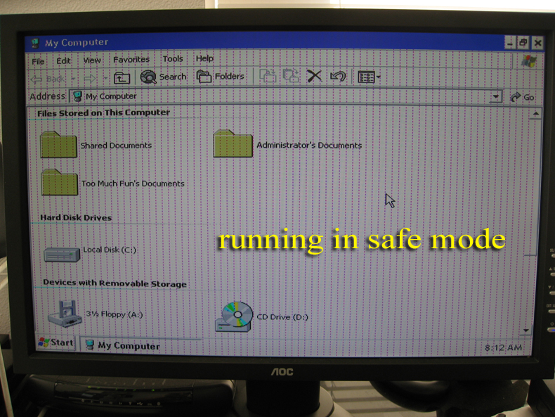

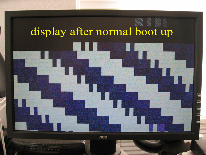

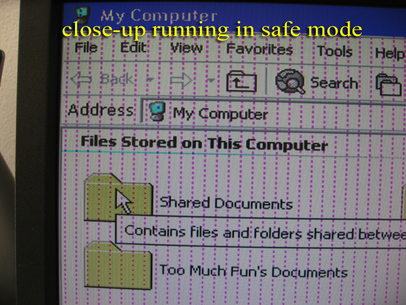

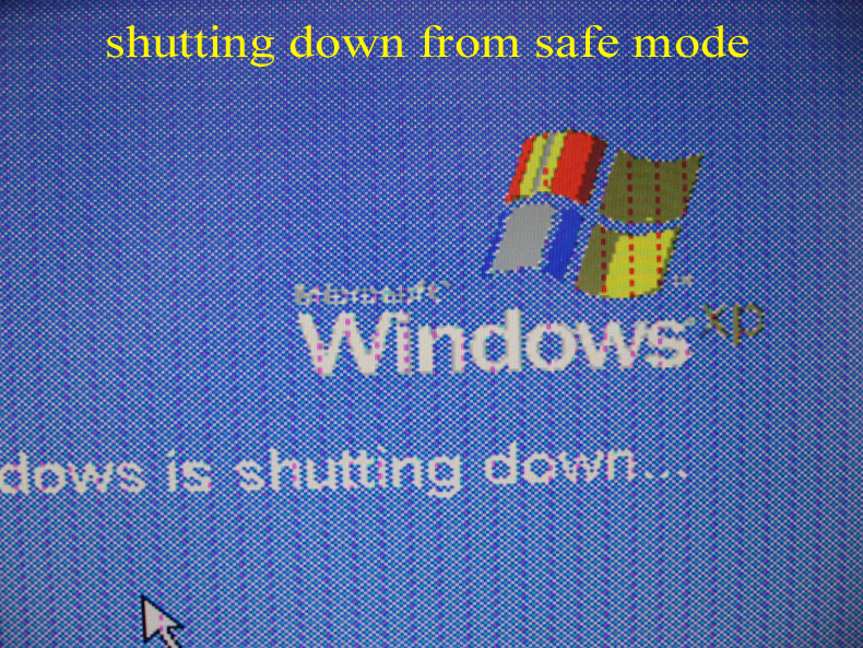

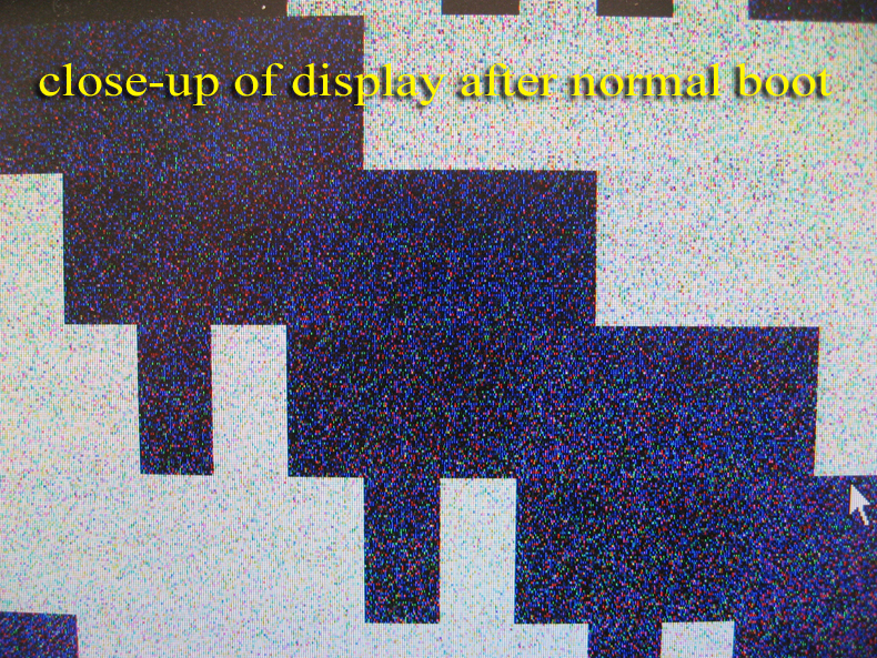

This is AAG's personal computer, doesn't access the internet much, no kids on it, was running fine 2 days ago, and now . . . . Pic's below.
I've already ruled out the monitor, but not the video card although I don't believe it's the video card.
I've run combofix.exe in safe mode as a precaution for viruses but nothing was fixed, can't find a virus on the system at all.
WTF? :frustrated:
HELP ? :banghead:

Well the good news is it's definitely a video or monitor problem.
Do you have another monitor that you can hook up to make sure it's not a monitor problem?
Here is what i would do, progressing to the next if it doesn't fix the issue.
  • Hook up another monitor to make sure its not the issue
  • Install the latest video driver
  • Replace the video card
  • Throw it against the wall
Replicator
UPDATE :
Indeed it was the graphics card, a shi**y little ASUS EN8400GS.
I replaced it with a NVidia GeForce 7950 GSX that I had laying around and BAM!!!
It as good as new . . . Thanks for the replies !
