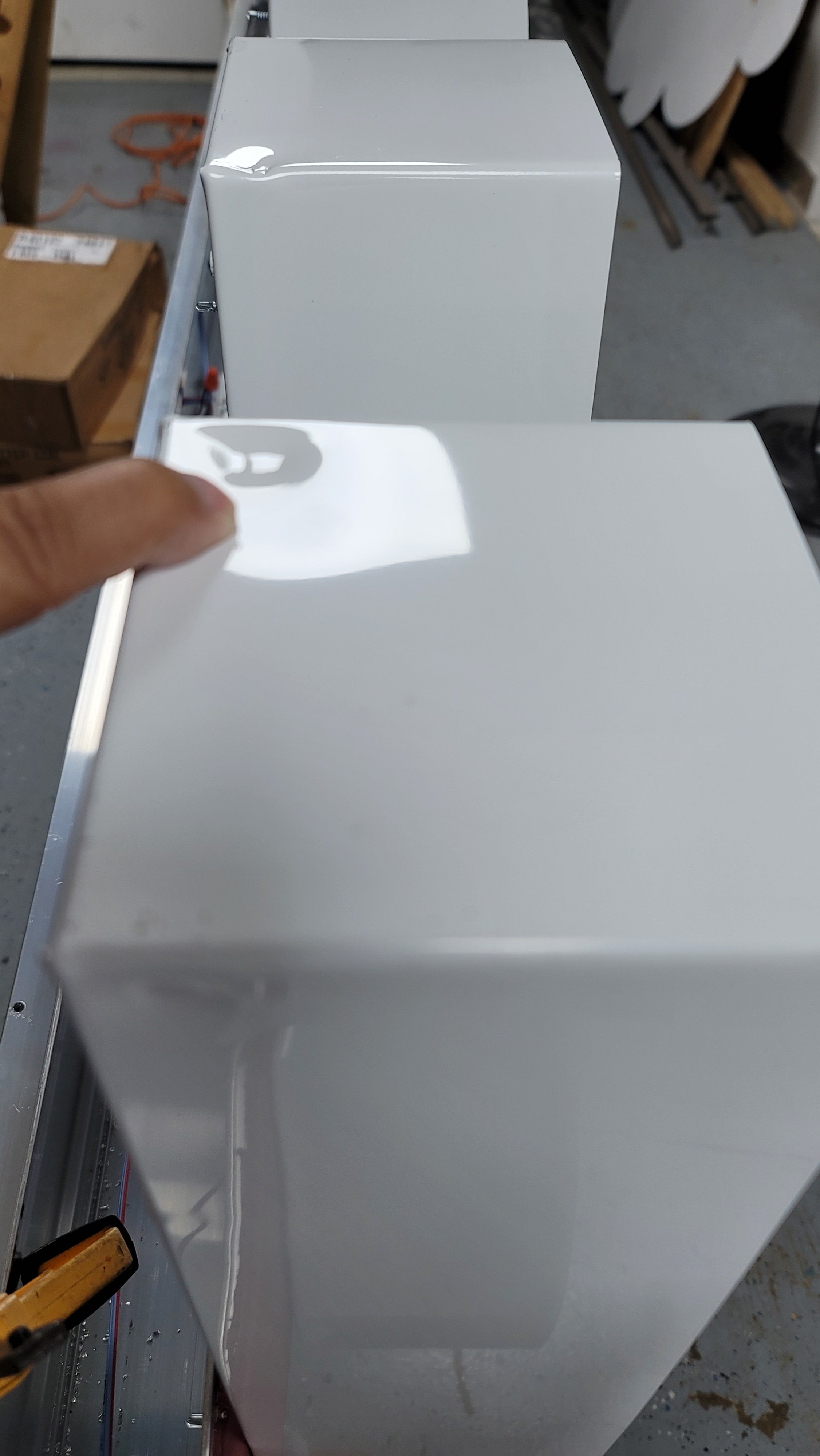

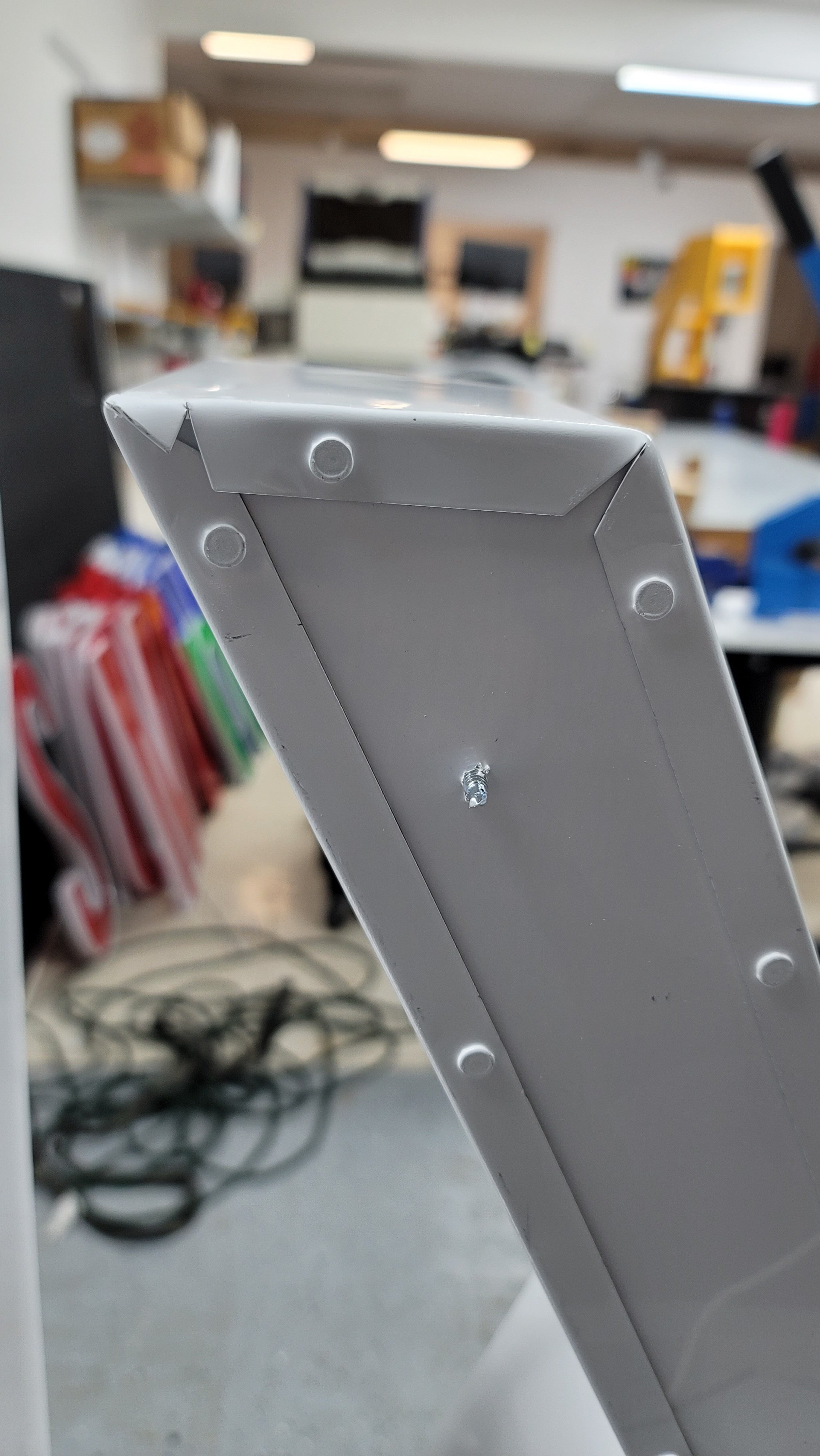

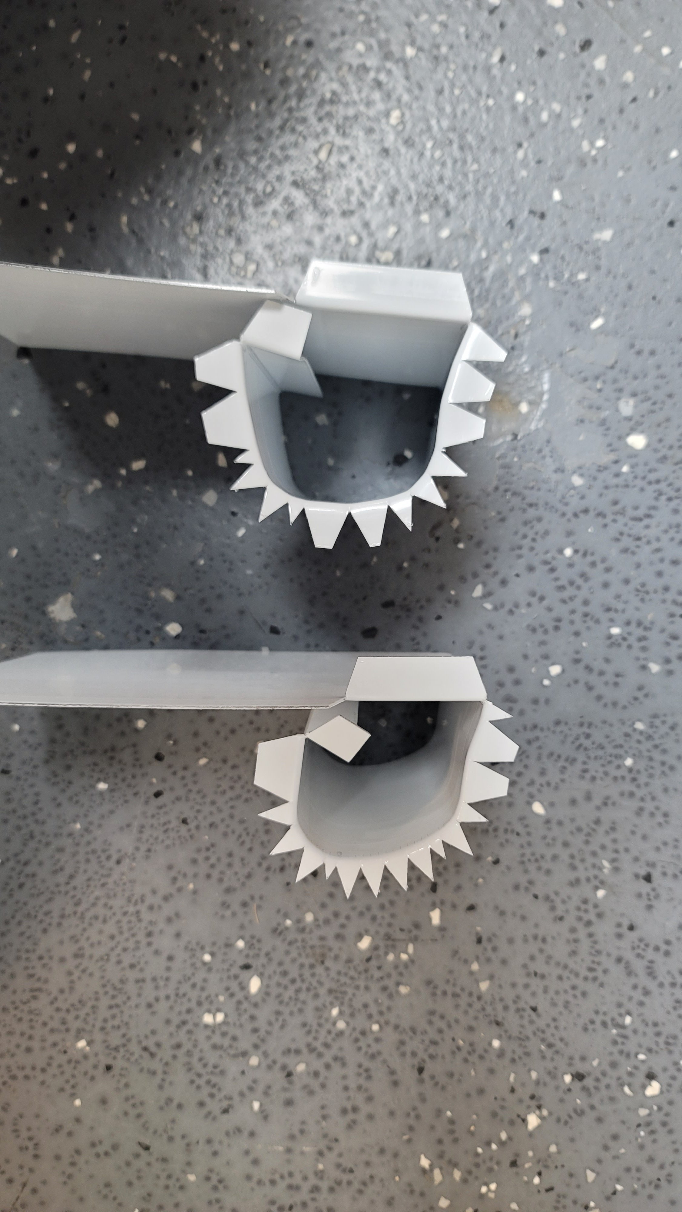

I bought an Accu Bend ACE+ for $47,000. After 30 days of use, I discovered that the machine is faulty and wastes a lot of material such as can not bending the star, cutting wrong and not wide enough,
causing the corners to overlap and wrinkle the corners.
The curves of all letters (q,e,R,o,p,a,d,g ,b, B, g, 8) will waste materials from 14" to 21" per each.
Computerized Cutters Inc. didn't fix it even though I persisted with the email many times. The director here told me to sell this machine to old stuff market if I don't want to use ACE +. He has broken his promise to provide a 3-year warranty on his product, which has only been used for 30 days. This is shameless!
Computerized Cutters please fix it quickly or not, please accept to return the device ASAP
