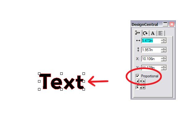

I use flexistarter sofeware and when I go to change the width it automatic changes the lenght. How can I change one without changing the other? Thanks for your help.

You can click and drag on any of the center drag points for a non proportional size change, or you can uncheck the Proportional check box in Design Central and your changes will only be on one axis at a time.
