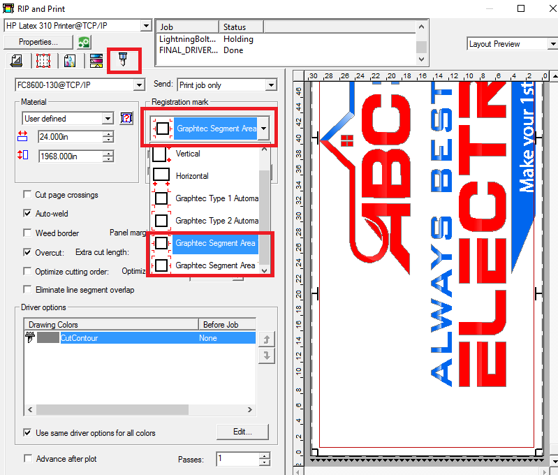

Awesome insight...thanks guys. I'm using Flexi...I haven't seen where I can put in extra Reg marks on that. Ill look into resetting it.
303DC
Here's how you do that. Please let me know if resetting fixes this for you. I just lost about $500 in cast wrapping vinyl/lam because of this same issue on a few 10' long panels.
attachment.php
I like how you can add extra reg marks, mine will only do the four outside corners.
Just wondering, we use the marks like what you have on the image, is there any advantage of using the marks
that are the mirror of those?
303DC
As far as I know, just printable area. You can squeeze in a little bit more printable area using the ones opposite of what I have selected in my screen shot.
