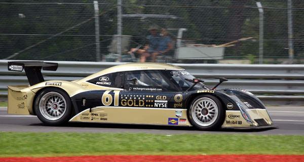

yes the car is a rolex grand am prototype and it will not be an easy install.
I am only to happy to do these added graphics as in past years i did everything, but the vehicle was painted. They have decided to go with the wrap as it is cheaper and it weighs 30 pounds less than paint!!!
I could never do a wrap for what these guys are getting charged so just as well. Although you say the 180 will remove if the heat is correct, I wonder if I should not just use removable vinyl, which seems more appropriate for this application.
Here is a pic of the car from last year, although this year because it will be wrapped I am sure the graphics will be a little wilder.
