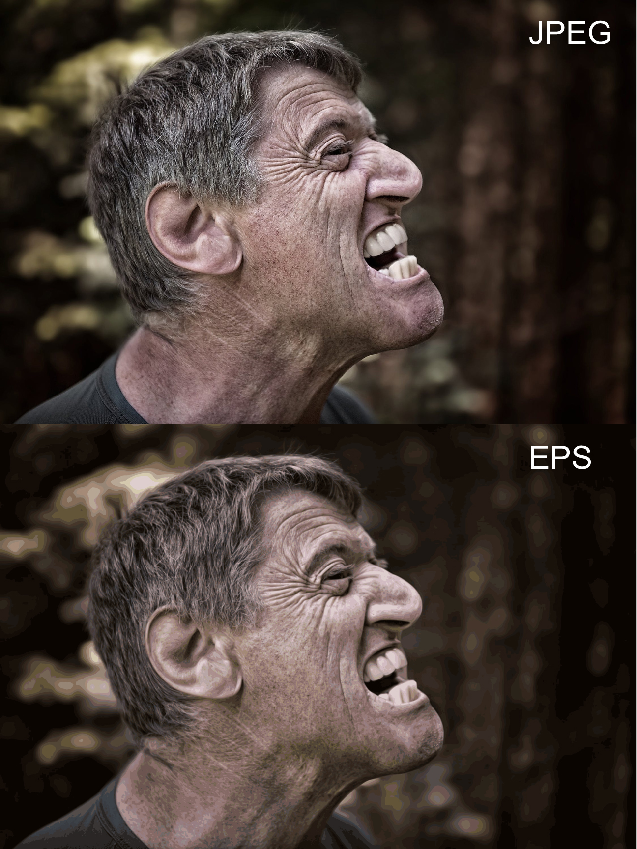

Here is an image of an original jpeg image with a lot of detail and below is the resulting eps file after I did an Inkscape bitmap trace in 36 colors.

I've heard of InkScape, but never tried it.
was that conversion example automated or did you manually recreate?

That was an autotrace that I set to trace the image in 36 colors (You can trace in as few or as many colors as you wish. It took about 60 seconds after opening the jpeg file to do the autotrace and save to an EPS file.

What's the point of turning a photo into a vector? Did you recreate it in 36 colours of cut vinyl? If you were just printing it, there are much easier and better ways to enlarge the photo.

I did it just to show that something with as much detail as that photo can be perfectly traced into a vector with little loss of detail. That is, after all, what the OP asked for, no?

No, what I understood from the original post, was that they wanted to convert to vector so they could enlarge a photo for a vinyl wrap. As I said, there are better ways to do that, for instance bicubic resampling (Image > Image Size in Photoshop), which preserves the detail in the photo. Your example lost a ton of detail when converting to vector, as is usually the case unless you have a gazillion vector points.
