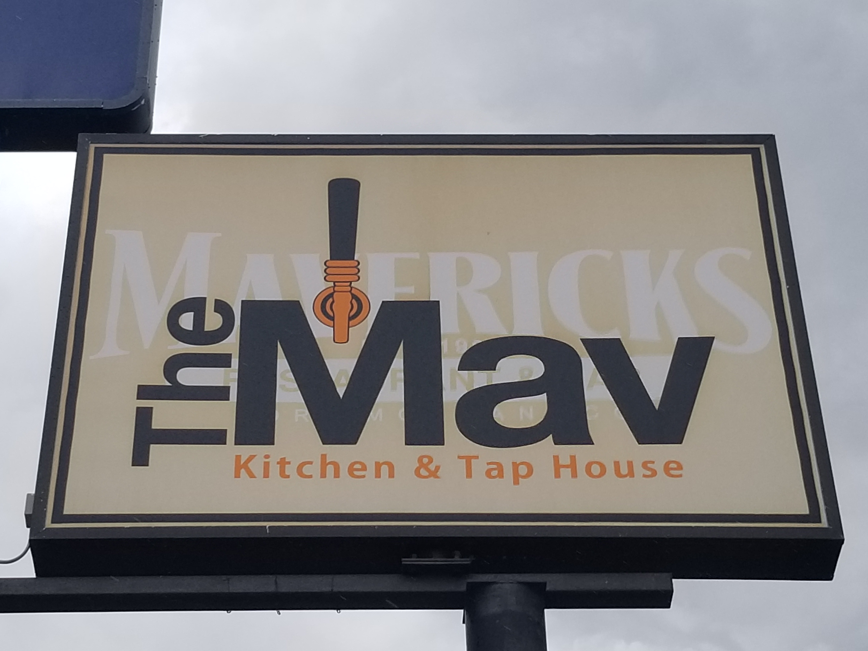

We have 2 signs made about 6 to 7 years ago that were made with new material and coincidentally both businesses changed names within 2 years of the installation so we peeled the vinyl and installed new graphics. Now about 5 years later, the faces have started to turn brown. The catch is, you can see the ghosting of the original graphics which are remaining whiter even though they were only on the faces for a year and it's been 5+ years since that vinyl was removed. And it's surprising how much contrast there is. We're not talking about a subtle difference between the old graphics and the area that has always been exposed. Where the old graphics were is still pretty white, and the rest of the face is quite brown.
For example, this sign was installed in Feb 2015. We peeled Maverick and installed The Mav in July 2017. The photo was taken a couple weeks ago. FYI, this is the west facing side. The east side only looks marginally better.

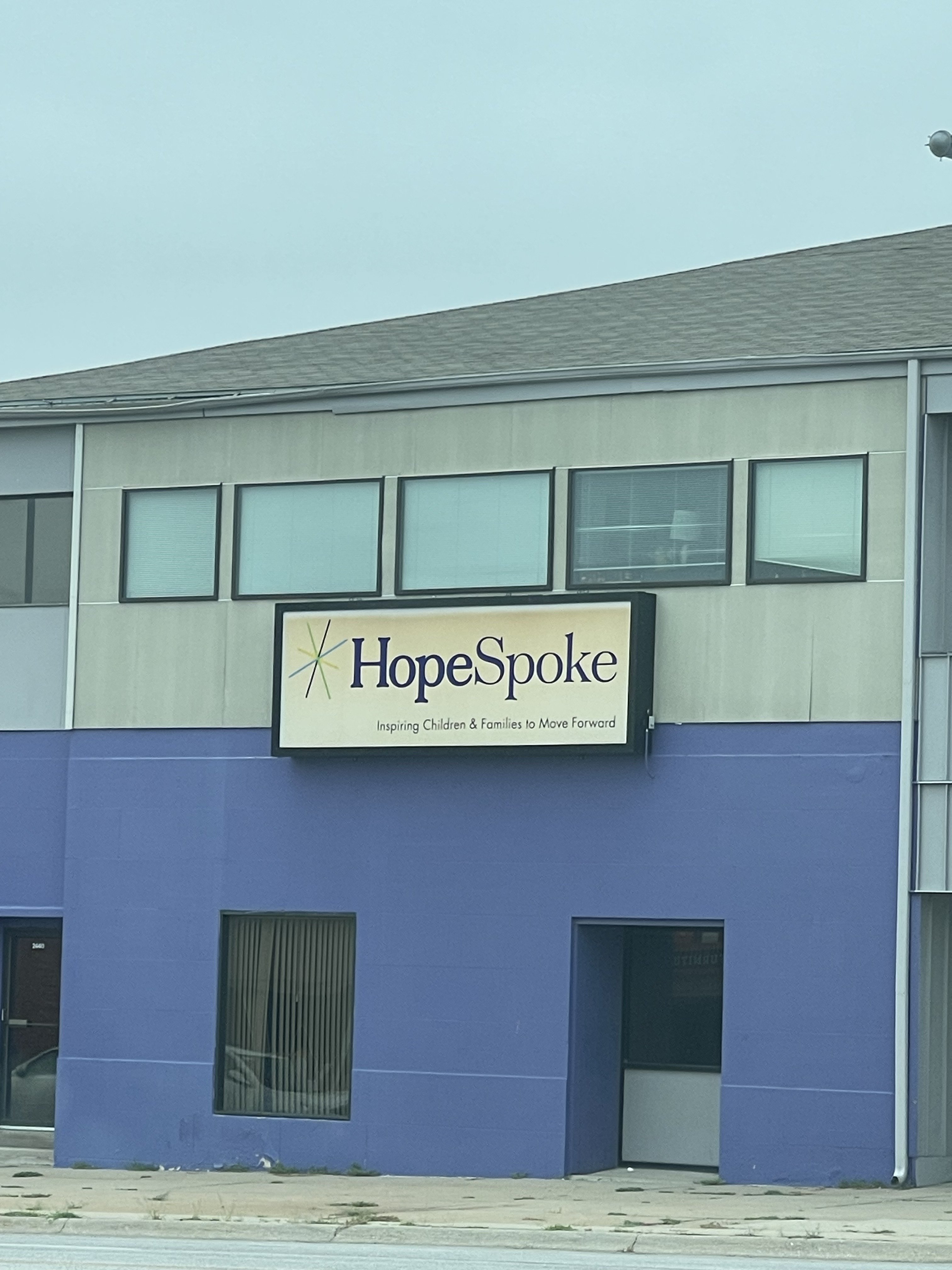

We have also been having issues with cooley. This sign face is only 3 years old, but it faces south so it's getting a lot of sun and tons of street traffic which seems to make it get dirtier faster. We've had a few complaints as of late and we're having to send crews to go clean these occasionally.
