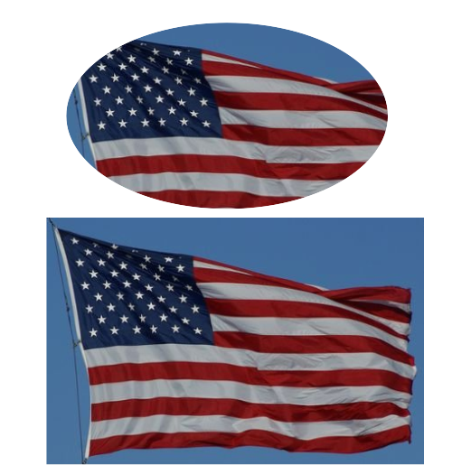

signage
like this?

I think in Corel it's called Power clip. But you should be able to search in the help files for 'how to create mask'.
You are on the right track. Create your vector shape or mask, then select both the vector shape and the bitmap, and hit 'power clip' or 'create mask' - or something similar to that.
Good Luck!
