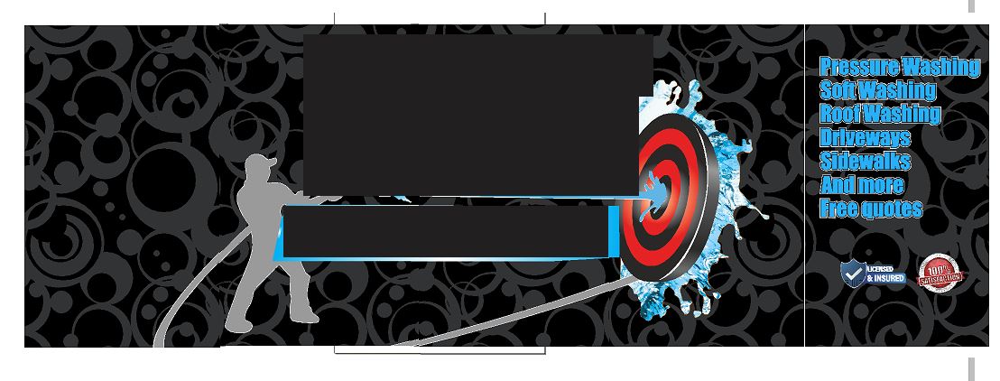

We are printing graphics for a trailer. powerwash company. The background is black with transparent bubbles on it. The background pattern is a fill in corel. So we created our panels. Each panel is supposed to match up with the next panel, including the bubble fill from corel. It looks like it matches up in corel, it looks like it matches up in flexi..when it prints, it doesn't match up. In fact, the pattern repeats in the background when printed out instead of matching up the way we placed it.
Any ideas on a work around?

I don't know much about Corel even though I have it. Can you save the panels as a jpeg and then print them? Does it have something to do with the auto fill? IDK - just throwing ideas out

How are you getting the files from Corel to Flexi? I didn't think Flexi could import Corel files, but I haven't tried in a while.
My thought would be like Stacey K and export from Corel in a raster format like JPG or TIFF. Or, like I've mentioned before, if I have trouble with Flexi "misinterpreting" a file, I use Photoshop to make it a raster image to import into Flexi.

I wanted to add, I find Flexi has trouble with transparencies, especially when created in another program. It also doesn't seem to export transparencies created in Flexi itself very well for that matter. In both cases, I find a flattened raster image works best.

I think it might. i screen shotted what it looked like in flexi. It PRINTED a repeating pattern. so i'm guessing it needed to be saved as a jpeg.
