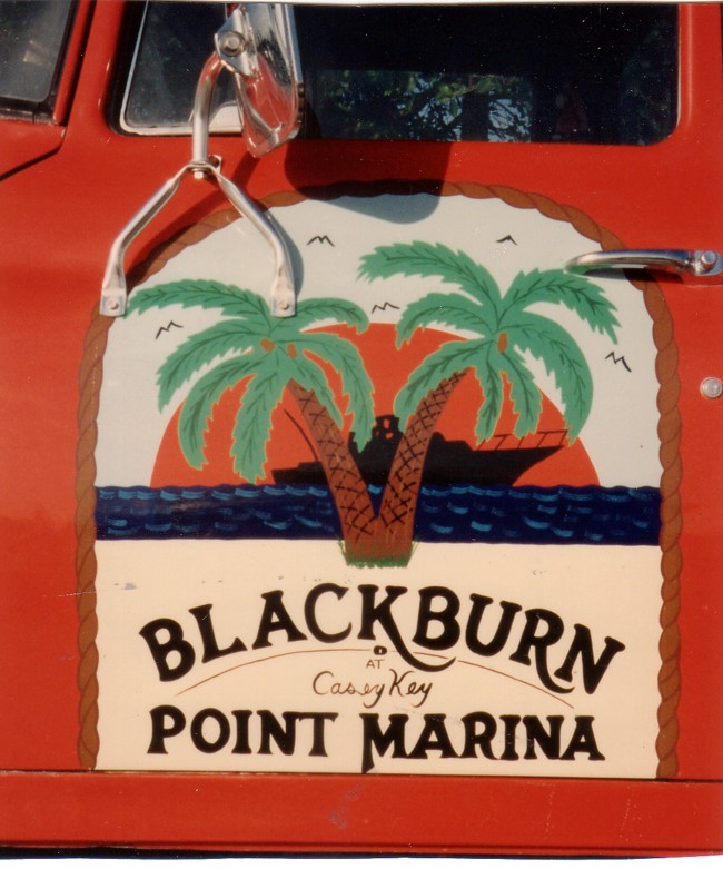

Thanks for everyone's reply's. However, I didn't see where any of it helped my problem. Not looking for free artwork, but I am trying to design a rope border around an oval that is 60"x32". I create my first object to start off. When I go to duplicate it around the oval is where I am having my problems. The problem is changing the location of the duplication. I followed the help guides exactly to the T, but when i get to where I should be able to change the values, there is nothing there to change them (refer to original post).
I agree Coredraw is a great program that integrates a lot of other functions from other programs, but the customer support from Coreldraw is way down in the dumps. So if anyone has information that could help me with what I am trying to do, it would be greatly appreciated! You can inbox me if you would like.

If you're trying to get a rope like effect wrapping around an oval I think the best approach would be by using Corel's blend tools. You can attach a blend from one source object to another along the length of a path and have those objects rotate with the path. Sometimes this works pretty well and other times it's a little clunky. Adobe Illustrator will allow patterns to be attached to paths. These work best with subtle curves. They don't work so well on anything tight.
OldPaint
like this?
