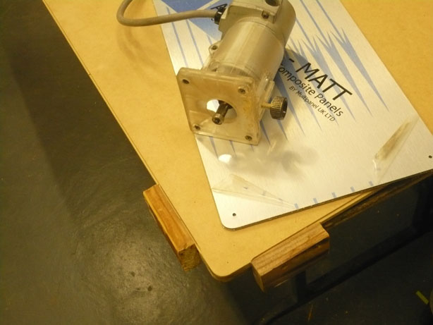

Craig Perry
cool, thanks for the feedback, ill chase em up, had to get something out the door fast so i ended up making a jig and using a hand router, worked bloody well actually...
