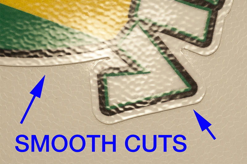

I have been having some contour cutting problems with my SP-540V, when the cutter is cutting you can hear and see what sounds and looks like steps, not long smooth cuts, looks like a jagged cut. I have ordered a new blade holder, however I don't think that is the issue. Attached are two images SMOOTH CUTS from a month ago and then the JAGGED CUTS as of the last few weeks.
Do you have any thoughts on what would cause the jagged (stepped) cuts?
It has been suggested I need to adjust the cable, can you explain how I do that? Thanks
