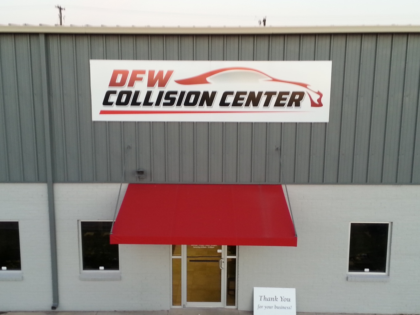

Nota very clear photo but this one was 4'x16' and was attached as noted above.....
