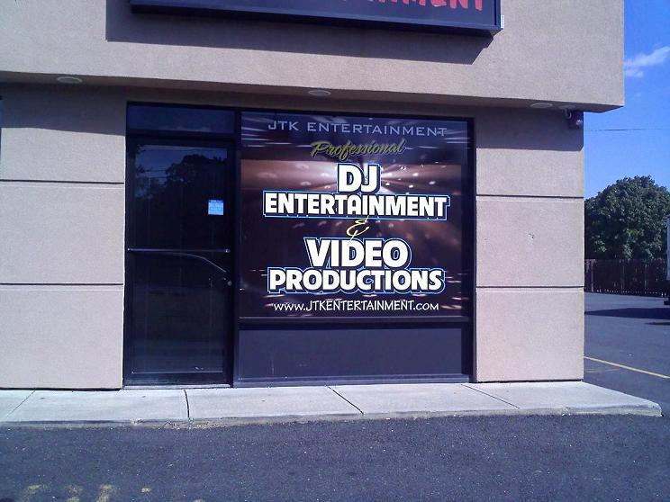

i have oracal vinyl on my store front getting ready to do the neighbors here with it also. no issues with mine so far:peace!:
things i've noticed.
i have a huge bank of windows completely sheeted out at a companies headquarters (approx 80 windows that are 4' X 18') been sheeted out in white since about 1999...no issues.
i had another large window (50" X 14') that was sheeted out in black that has no issues that is subjected to constant sun
and i had a drycleaners windows that were painted black and popped and then crackedthe first summer....
these are just a few examples. i was taught many many moons ago that if i was to paint out a background on a window that i was to leave a border of exposed window and not right up to the gasket...never made sense but i have seen many windows that other ppl have done that have popped that had no border....i say popped because it almost always appears that the window seperates at the gasket that holds it in place and then cracks out
so my thoughts although there is no science is that the vinyl windows are not retaining the heat like painted windows.
i got to a point where if i am going to sheet out a window i am going to advise the client and have them sign away any and all liability on my part...and then i will do whatever they want me to do

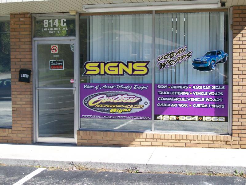

Full coverage, south-west facing, 4560GTX with 210 gloss laminate. Took this pic last week. I installed it over a year ago. So far, so good.
