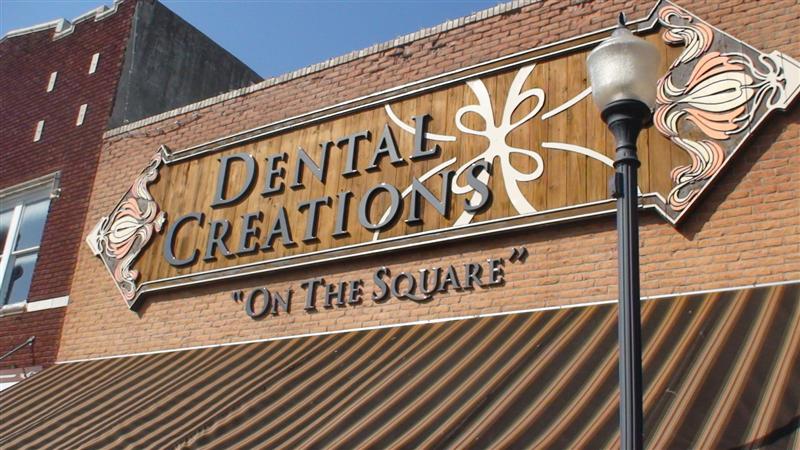

I don't see any problem with a stud and pad mount and clear silicon. The pads adjust to irregular surfaces. Studs will help hold them in. You really might not even need the studs but it would be extra security.
These were just pad mounted with clear 100% silicon.
