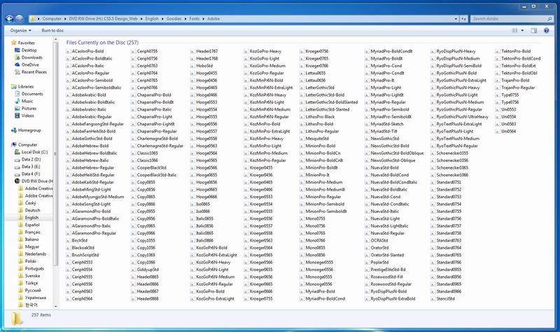

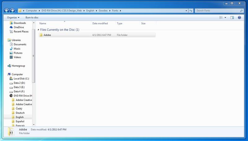

Bobby, I have attached 2 pictures of what is on the other disk. It shows the fonts some of which show up and some don't. Is this all the Adobe fonts your talking about on the Cloud version? Also any idea of how i can make sure they are all on my system. Keep in mind I am starting fresh do to a virus so now is the time to get it done. LOL

As for the fonts shown in the disc's fonts folder, Adobe does not necessarily install all of those typefaces when you install a copy of Creative Suite. You just have to examine the fonts you see show up in the font menu and compare that versus the fonts on the DVD-ROM disc. If you see something on the disc that isn't installed and you like the typeface then use the font manager of your choice to install it. I usually copy all the fonts from such discs into a font collection folder on my computer's hard disc drive and install from there. Sometimes Windows can be an idiot and install fonts without copying the fonts into Windows' fonts directory. It sucks if it just makes a short cut to the font on an optical disc.

Go to that folder on the CD, "Select All", Copy, go to your windows font folder (usually C:/Windows/fonts), paste.
If they're already installed, then it will ask you if you want to replace the ones that are already installed.
