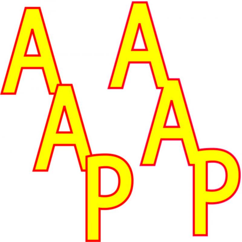

ok, that works pretty close to what I am looking for. however now the letters are connected, what I am looking for is to just put a cut path around the outside of the letters that are connected without actually making them blend together like the star and box in the tutorial. so, the star would stay orange and the box would stay grey and the cut path would go around the outside of both. As you can see with the AAA logo the yellow blends together when they are expanded. The AAA on the left is what I want it to look like

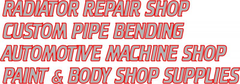

as you can see on the smaller text the letters are touching. I want to get the cut path around them and was hoping there was a faster way than using the pen tool.
