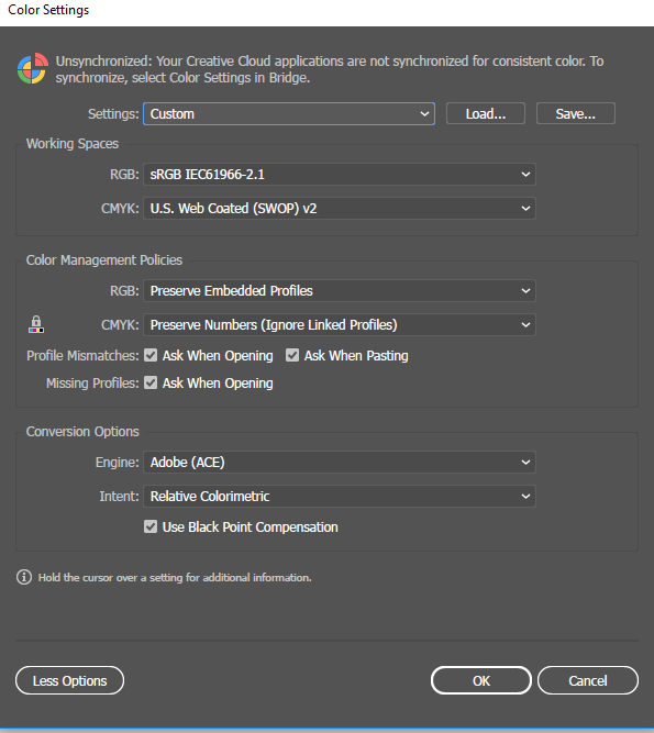

Here is the color setting in my illustrator if that even helps lol.
