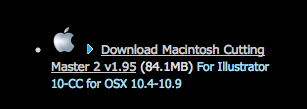

Running Adobe Creative Cloud 2014 on a Mac and have a Graphtec FC7000 cutter. Does anyone know if there is a Cut Master program for this cutter that will work in the latest version of Illustrator? I see there is one for CC -- downloaded and tried installing it but it don't work in CC 2014.
.94 appears to be the Windows version.
.95 is the Mac version -- I've tried installing on two different Macs -- No Go

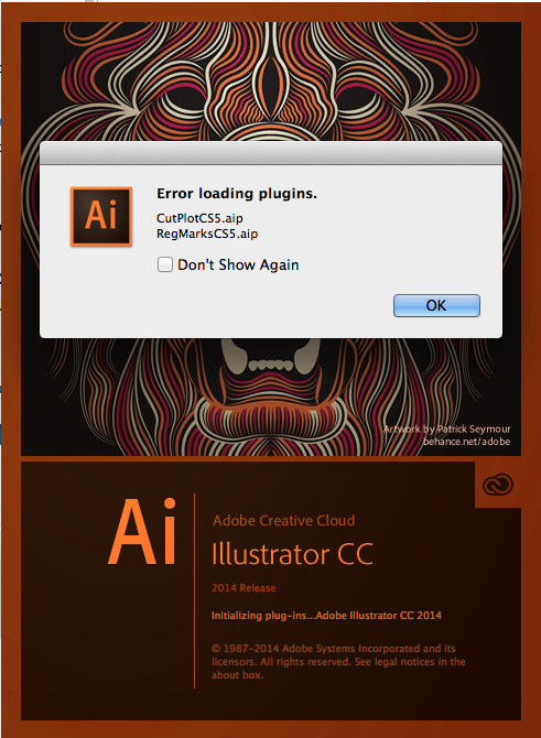

See picture for the warning that appears

dypinc
Go to /Applications/Cutting Master 2 1.95/Plug-in/CC/CutPlot403 folder. There is a folder called CC in there with the correct plug-ins. Copy those to the /Applications/Adobe Illustrator CC 2014/Plug-ins/CutPlot403 folder. Remove the plug-ins for CS5 in the /Applications/Adobe Illustrator CC 2014/Plug-ins/CutPlot403 folder.
