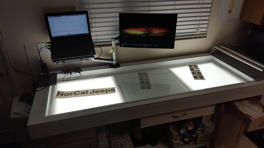

made a custom shadow box light table. 28'x7' . It has 3 24"x24" LED remote control Light panels under glass that i can turn on anyone i want depending on the size of design i have. Lets me see thru all the layers and allows me to layer thru them as needed. Makes life very easy. Here is a simple video and photo of it the first day i got at home. Its now much more organized and no longer storing vinyl under the table.

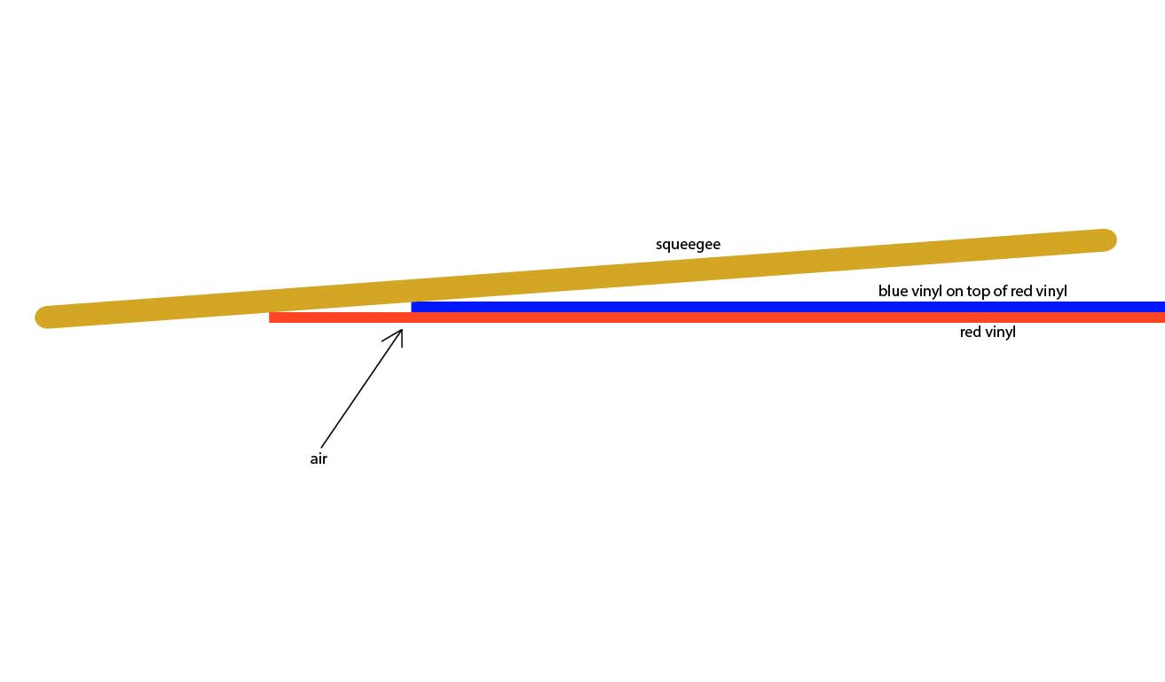

i tried doing that a couple of times where I will tape the two colors or layers and it left bubbles right where the two colors met so I went back to doing it layer by layer in my case it did not make my job easier after having to pop all those bubbles
Agree with asd. In general that saves no time installing but actually makes for a lower quality install because you get a line of air around each layer and you end up spending time trying to get the thin line of air out from around the layer edges. There is no way around that either, there will be bubbles on installation. The only way to prevent that is to install each layer one at a time, butt layers with no overlap, or just print it if there is more than one color.
