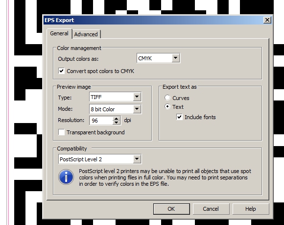

Hey guys, For some reason my spot color CutContour isn't showing up in Versaworks.
I am exporting as a EPS and even tried a new document with a no fill shape with a cut contour line and it didn't show up as "dancing ants" either, Just a pink line in VW.
Any ideas?

uncheck the convert spot color box...once exported it is no longer a spot color which versaworks needs to differentiate print vs. cut.

Tried that, same exact results. I created another new document with what i need to print and still the same.
Using Corel x6 and the latest VW

i know with X5 that if you don't use the spot color in the pre-loaded roland colors it wouldn't show up.
I tried to create a spot color like i have in previous versions of Corel and it wouldn't work.

Well, finally got it. I had to go into the Roland folder through Corel and use that spot color vs the spot color CutContour i pre-made.
Mike is spot on!
