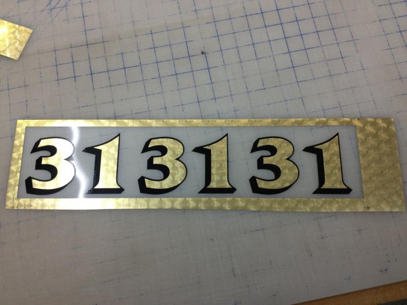

I'm trying to cut some decals out of solvent printable signgold. My cutter isn't correctly reading the registration marks.
Any ideas?
I'm using a Graphtec FC-8000.
Shadowglen
are the marks a little transparent? I was told to cut out black vinyl the same size dots and put them over the printed ones and it will help. ? I was going to print on a blue metallic but have not tried it yet.
Charlie J
I ended up having to re-print and change the registration marks to manual mode. Talk about a super pain in the @ss....I got it done though.
