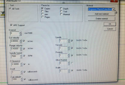

I have a Vision 2550 Engraver and need to cut 1/8" Romark engravable material. I have an 1/8" router bit and I am not sure what settings for speed and rotation speed to set it at. I hope this makes sense to someone. I'm afraid I am going to break my bit cutting through this thick material. Here is a picture of where I make the settings.

I have run it at full depth at 2.5 IPS but if I were you I would do 2 cuts at 2.5 and see how it goes. If it is small enough I would use my laser. I have a 48X96 Shopbot with a 2.2kw spindle so take this into account.
aslater
I use a 1/16" bit at 12k rpm, 4 passes at 100 ipm. I would think an 1/8" at 12k rpm, 2 passes at 100 IPM would be where I would start.
Alan
aslater
This also depends on the bit you are using. I am using LMT Onsrud 63-602 (1/16") and 63-610 (1/8") which are both a single flute.
