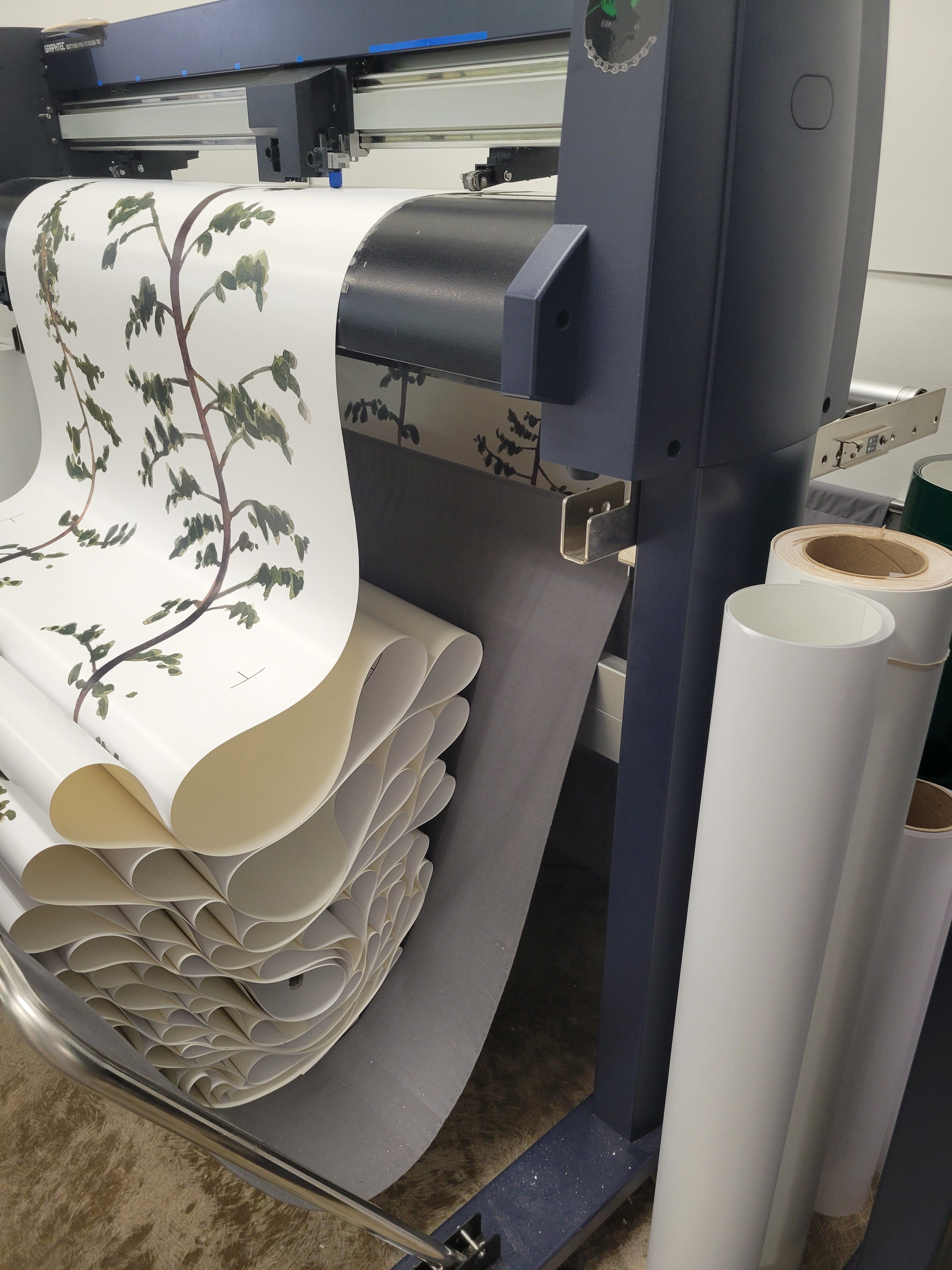

We have the HP Print and cut 54" cutter ( Think it's a Summa rebranded) I have heard you can cut By rolls but My question is, where does the cut media go, because the basket could only fit one or two of our sheets 54"x46". Imagine printing for an hour without a take up reel, the media would jam up and eventually cause a headstrike, same thing here it would jam up and cause inaccurate cuts.
victor bogdanov
whole roll should fit into the basket no problem or let it go on the floor. Or get a takeup system. you can print without a take up reel and just let it fold up on the floor

but you can cut full rolls without take up no problem, I do it everyday. Will post a picture of full basket later today
