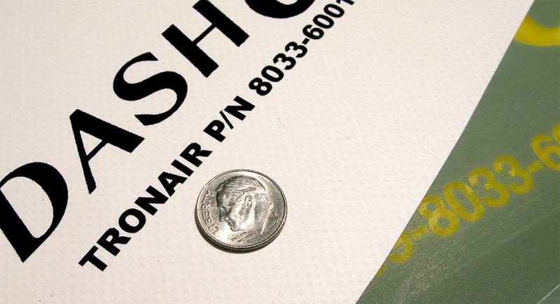

I started with a 3rd gen. Xerox that was made into a screen print Pos. .. I scan'd the Pos .. opened in Photoshop ..added the type and saved as a .tif.
The PITA was it took two days and a lot of help in a Flexi forum to find that my Mac version of CorelDRAW 11 did not have a trace function. I was only able to export a bitmap?! Turns out there was a stand-alone app on my Mac all the time Corel TRACE. Dead easy.. 10sec. Then Flexi Starter imported it .. compiled it .. cut it.
Lotsa things to learn yet, but I'm off an running....
Jim
Summa D75R .. 36deg. Clean Cut blade .. 40g pressure .. Oracal 651
