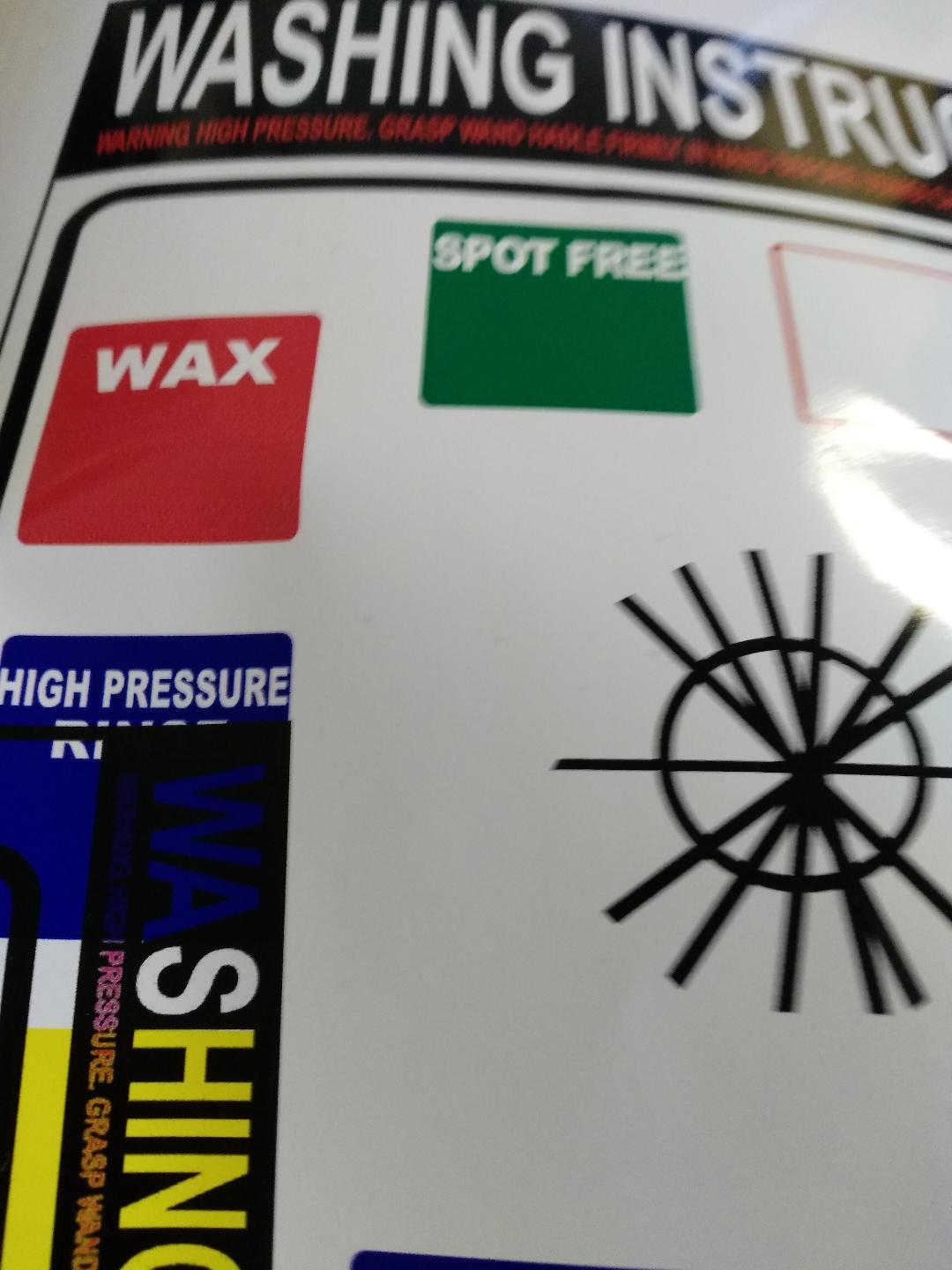

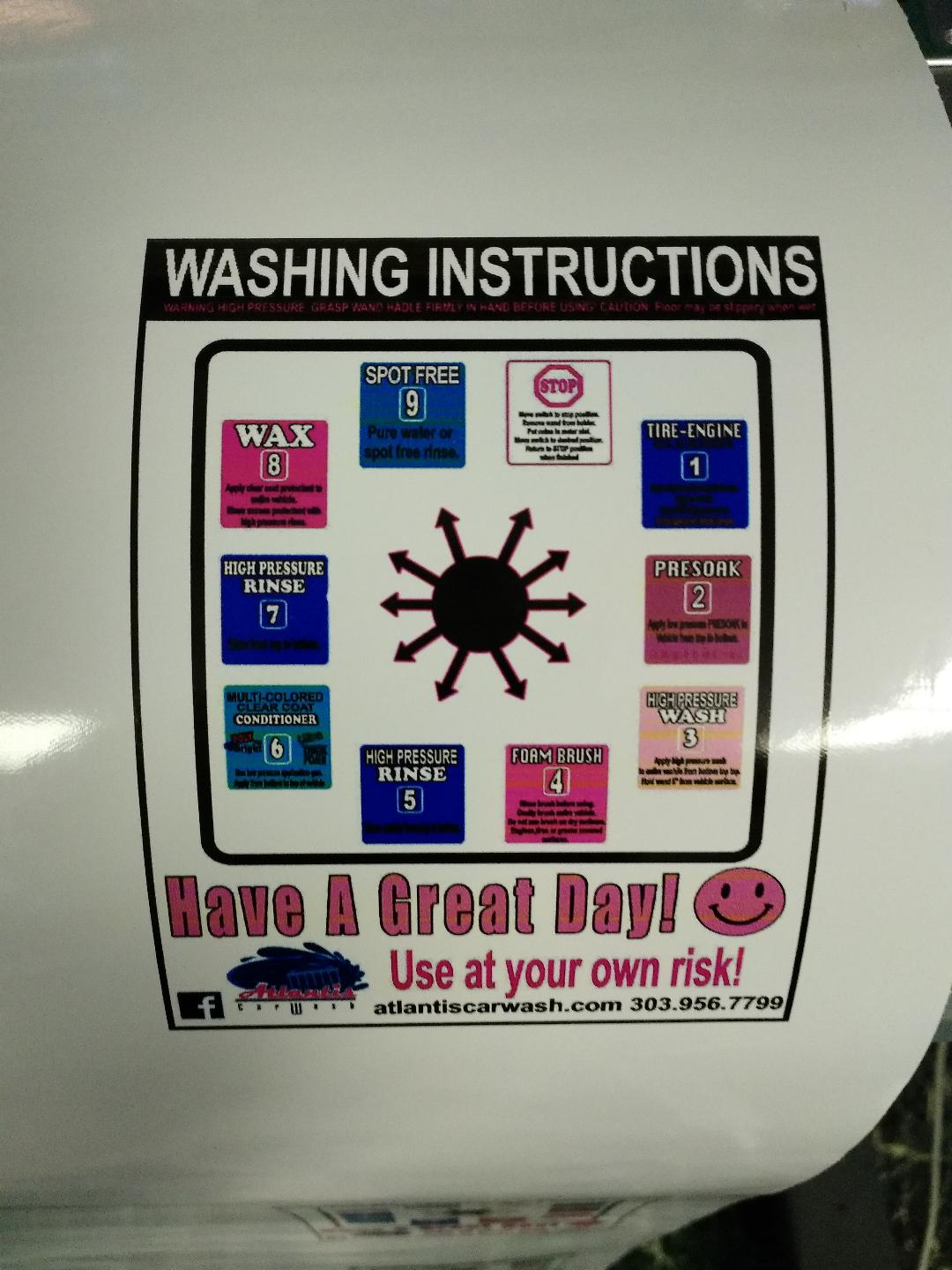

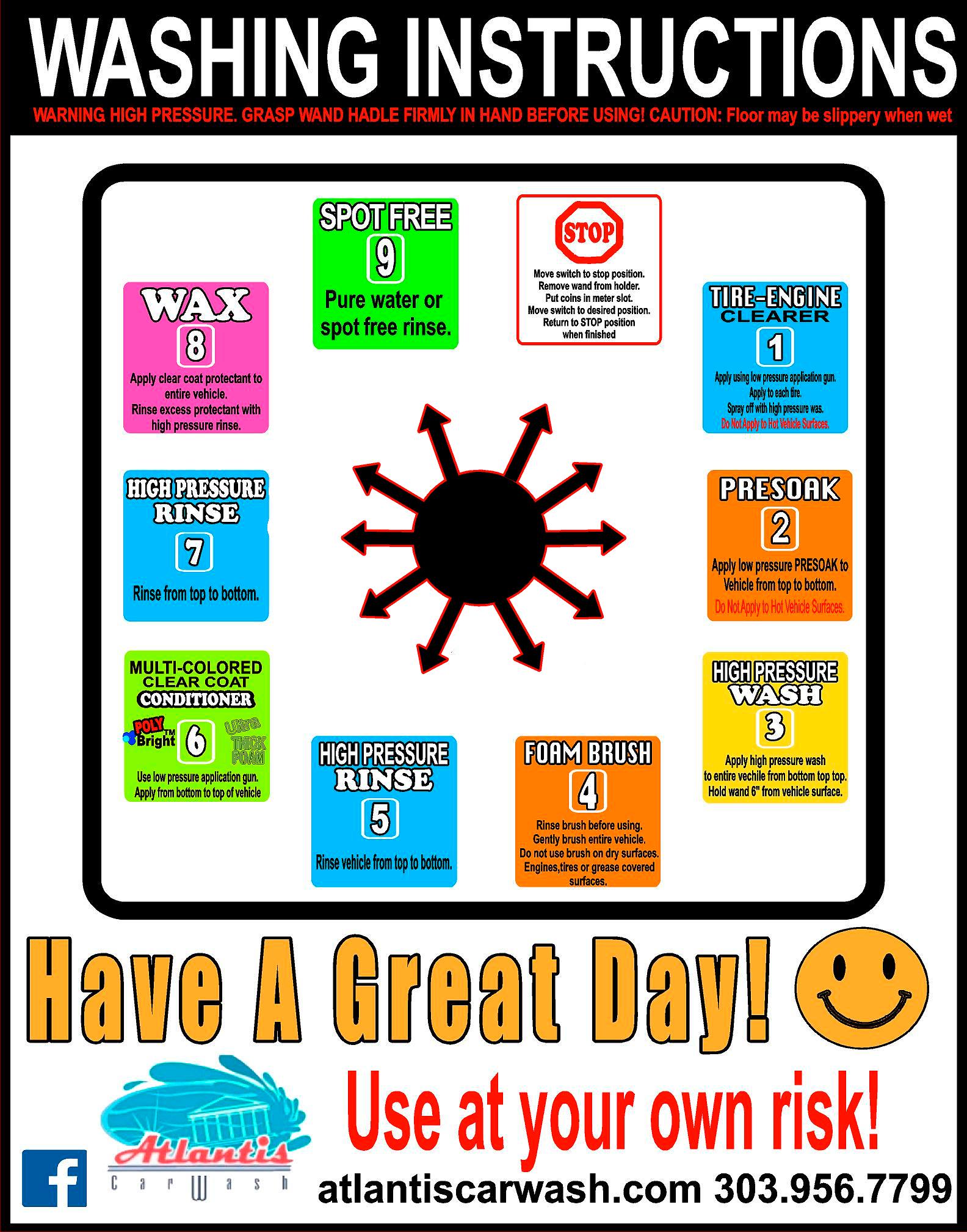

Thank you...I have attached one of what it suppose to look like (1st one), one of playing around with the output (2nd one) and one of dark it original prints. Any help would be GREATLY APPRECIATED!! :)

My first impression from the images is your yellow is not firing. I'm thinking you may have some nozzle drop out and/or cross-contamination. How does the nozzle check look?

I think you probably have a cap top issue and/or the pump system is clogged. The nozzle check has to be missing a bunch of nozzles to print like it is above. The cap top is probably failing and the cleaning cycles are just not working properly.

Hi :) yes, yellow is clogged. Try to print a 30 cms long yellow patch after a cleaning. If it starts printing ok and yellow dissapears before that 30 cms, probably air is entering the tube (check dumpers first) or its clogged from inside (have to insert a little ink solvent with very little pressure, Wait some minutes and suck softly with a syringe from the yellow dumper placeholder). Of course, first check that pump is firing ink while you are doing the cleanings
