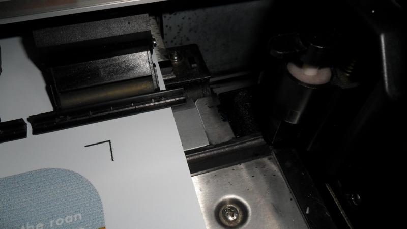

Attached is a picture of the problem I trying to solve. It's a small puddle of ink dumped just after the cleaning pad. Do you have any idea's what causing this. Is there a way to manualy move the head, so it would line up with the capping station?

randya
When was the spit pad last replaced?
You probably need to look and see what is happening.
And see if it is spray on the platen or bouncing off the spit pad.
I just replace the spit pad a couple of weeks ago. The ink seems to be dropped there during the printing and not the cleaning.
AUTO-FX
Mine did that regularly, but it was just a bit of mist, no real spitting happening. I assumed it was normal. It did spit, however, if I had any buildup around the perimeter of the black head.
